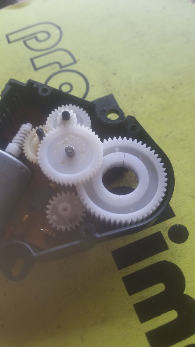

I suppose this is the culprit that's causing hot air blowing on the drivers side. The cracked gear. This is located on the passenger side bottom near the center console. Let's see if I can get a replacement part as opposed to paying over a hundred for a new part.
Old Aug 4, 2020 | 02:32 PM
That is and the large gear is what cracks just as yours did and causes it to fail.
