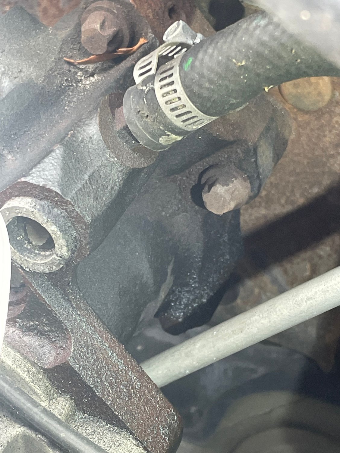

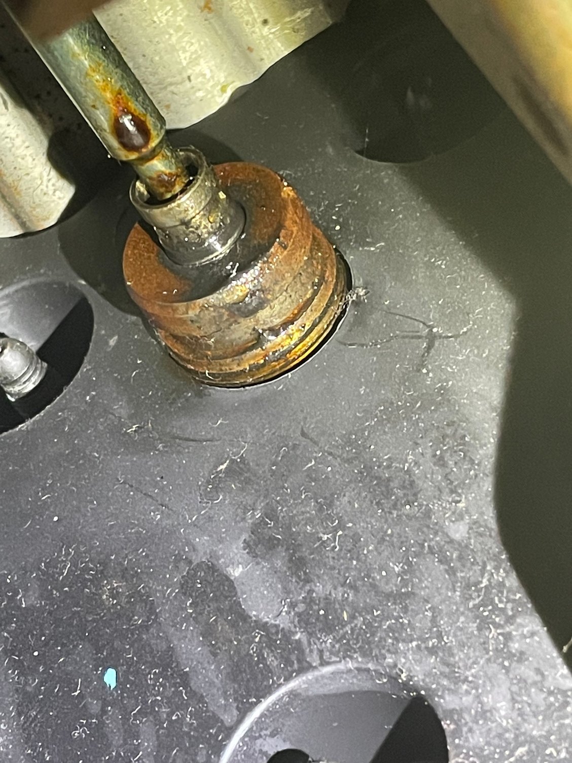

Anyone on this forum tackle the break booster replacement by any chance? Appears that ours is leaking from under the hood and also at the brake pedal, there is definitely a lot of play before the breaks are activated. Looks like another project along with replacing the steering box.

it is pretty straight forward to replace. you might curse a bit when you get to the nuts between the brake peddle and the gas peddle. the brake switch clip might also need a few words before it releases. i had just a drip from the area you posted the pic of and used AT-205 https://atpautomotive.com/re-seal added it to the power steering fluid. that stopped the leak for 2 years until i finally replaced the unit during an overhaul i had also replaced the steering pump and lines i left the steering box

Bronxteck suggestion of using ATP/s AT-205 is an excellent one, for a few bucks you might totally resolve the deteriorated seal and stop the leak. If it doesn't work you will at least buy yourself some time before you have to replace the hydroboost unit. (which isn't cheap)
If you find out this does not solve your lead consider and you plan on keeping your H2 long term then just buy a NEW AC/Delco unit and not a rebuilt one (unless you like doing stuff more then once) Another options is check out A-Team performance they sell a seal kit if you wish to try your luck trying to replace the leaking seal. I have done this myself and bought about a year before I said screw it and just bought a new one, many times its not just the O-ring thats the problem but excessive bore wear where the piston travels and replacing the O ring will just buy you some time.
