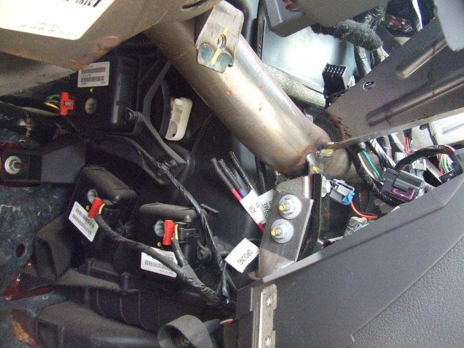

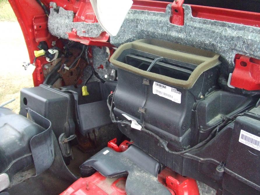

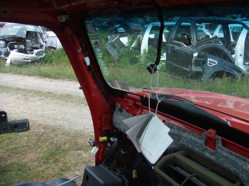

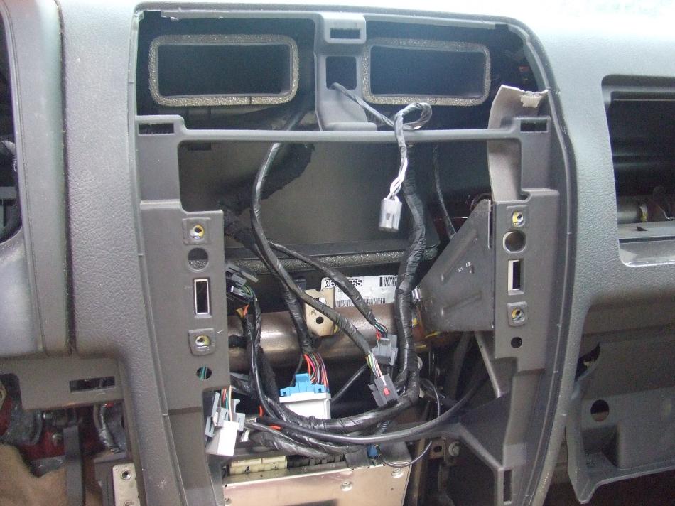

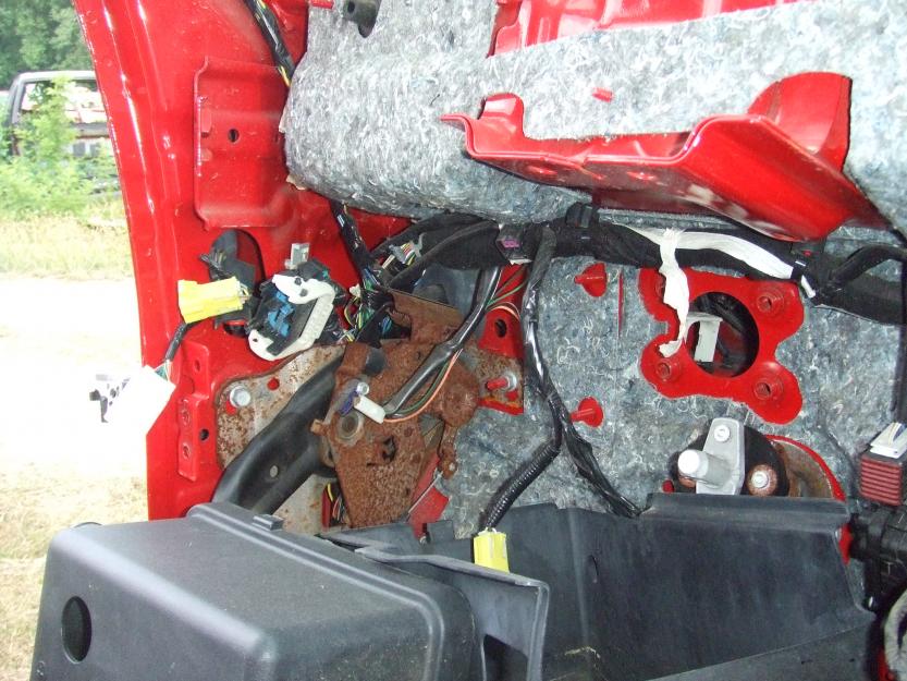

This may or may not help you, But since all our H3's are dismantled i can see what is behind the radio/dash etc ...
Attached Thumbnails Wireing woes in new to us H3-dscf5264.jpg   Wireing woes in new to us H3-dscf5265.jpg   Wireing woes in new to us H3-dscf5266.jpg   Wireing woes in new to us H3-dscf5267.jpg   Wireing woes in new to us H3-dscf5268.jpg

Thanks but, thats not really going to help. I need the color coded diagram so I can see what goes where. Looks like the wiring is all the same .
