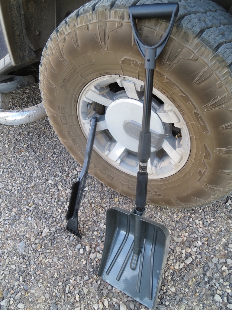

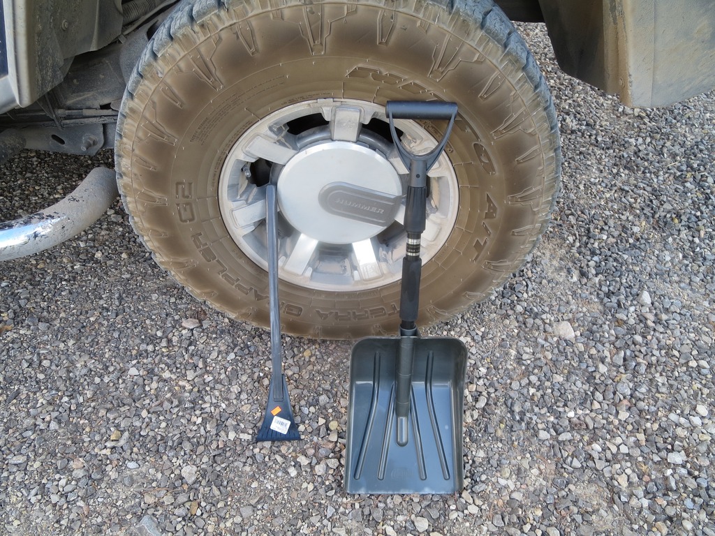

Last winter was my first ever not living on the Gulf coast. This truck impressed me so much that I wouldn't trust something else up here in the mountains. Most of the time I could in 4-HI, occasionally 4-HI Lock and once in awhile 4-LO. With the Nitto Terra Grappler G2s it just slugged through up to a foot of snow. No slipping on icy spots, even on hills. Very impressed.
Agree about the washer fluid with antifreeze. You might want to get a long ice scraper to reach over the hood, I have some that are 18" long. If you don't already have all-weather floor mats you may want to grab a set of those. Ruined a new set of factory mats with snow and mud last winter. I also found a small collapsible shovel at my local Air Force Base that's ideal for small piles of snow and ice. Hey Doc MI, what's the correct terminology here for "piles of snow"?
Only issue I had with the cold weather was my transfer case motor on the '04 didn't like anything below 40º. Wouldn't shift and gave me the warning in the DIC. After getting thoroughly warmed up I could shut the truck off for a couple minutes (usually while going into the post office to get mail) and when I started back up the system was ops normal. Changed the motor and that was fixed, but something to watch for. Have a fun trip.
