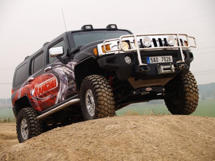

I have 2'' spacers and it seems to be good for short and trial stages/ways. In the long term view the right half shaft has to be changed every 10000miles and after 30 000 miles the steering is gone. But it is the same effect like backspacing.
