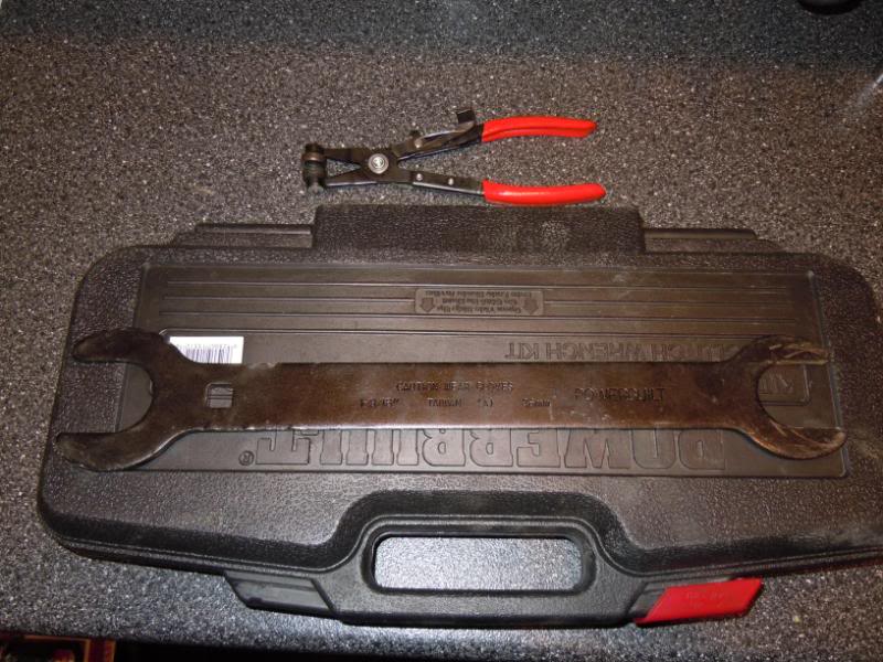

Most auto parts loan the clutch fan nut wrench out free with a return deposit.
