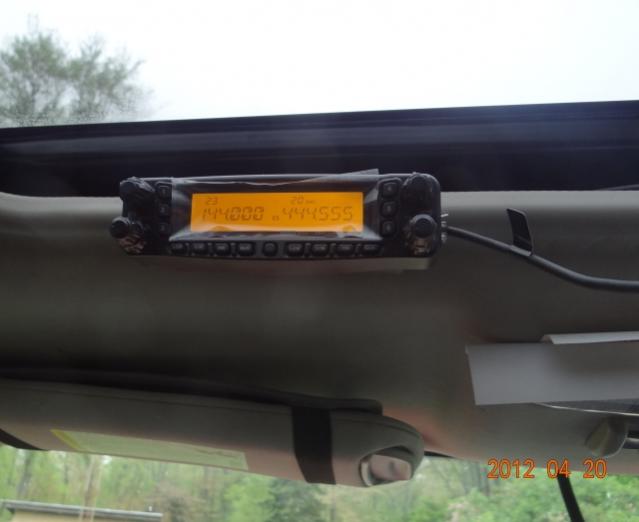

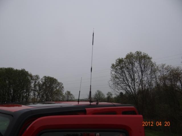

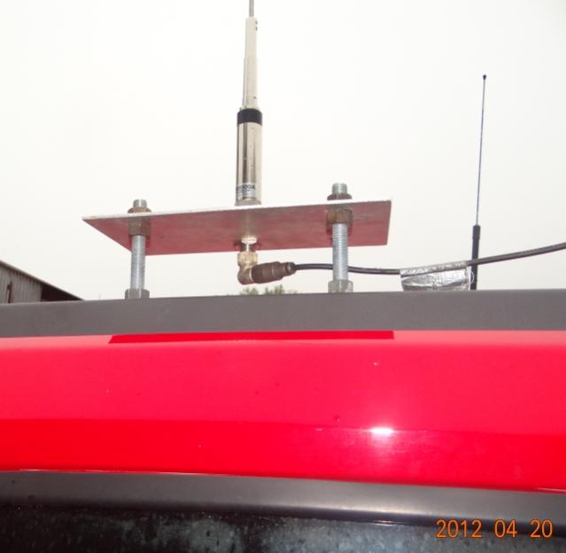

heres a look at a radio face plate mount and an "ugly" but solid temp mount for a heavy antenna. the smaller ant is a dual band 2 mtr/450 and the big,"ugly" one is quad band but this plate would do good for cb as well.
ugly but solid and functional.

what you may see someday is a face plate mounted on an aluminum bracket in the skylight area and hanging in the drivers face.
then 2 antenna pix. the ugly one mounts in the roofrack track with the same carriage bolts i use for my 2x4 roofrack. this could be a cb antenna.
the small 2 band ant mounts with a motorola roof mount,right in the center, almost.

update, the "rack mount" antenna bracket is not ok.
the channel has a lot of "wiggle room"when used by its self. when a cross piece ties the 2 together they cant wiggle, alone they can. so back to the design "lab" for reinforcement. maybe a single bolt on the other side and a thin cross piece.
