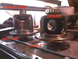

Doc olds, We replaced the ring and pinion with Yukon, the spider gears were perfect to my luck because we couldn't find them any ware except from GM at an outrageous price, the oldcarrier hub was cracked in two places, I'm positive that the carrier hub is one of the Major causes of the failure, as you guys have heard, many people on this form have been complainingabout a vibrating noise coming from the front endwhen coasting at 50 MPH well it's because the carrier hub is cracked and the ring and pinion are out of wack now, I had the noise for about 3 to 4 weeksbefore the diff disintegrated, of course notknowing at the time and also thinking it was a heat shield or something like that. The secondmajor thing we noticed was the pinion was not shimmedproperly by GM, when we reassembled the new gears we had to add 1/4" of shims to get the proper backlash, the backlash should be nomore then .08 without the extra shims we were getting .22 NOT GOOD!!we went back to look at the old gears,the markings that the pinion made on the ring were at the very top of the gears, again NOT GOOD!! they should be in the middle of thegears, this means the backlash was wellbelow the tolerance for any diff out there. My honest opinion is that I really don't thing it's a question of the aluminum carrier causing this, I think it crappy gears crappy carrier hub andvery poor setup by GM.
Sorry the picture is not great!! cell phone LOL

There is one important thing for others to know, if ever you try to rebuild the H3 front diff the spider gears as mentioned earlier can only be purchased from GM and also the carrier hub, the hub is specific to the H3, the one I ordered at the time did not fit the carrier,the place we got it from said that they were sure it was going to fit, they called me back the nextdayto apologized and said the only placewe will find it is at GM, the guy felt bad so he gave me a credit for the hub.We called GM, the price was 375.00 + 150.00 rush charge[:@][:@][:@]
so I took the free hub and machined down to fit and welded the front plate to it as you see in the picture in my other post.
