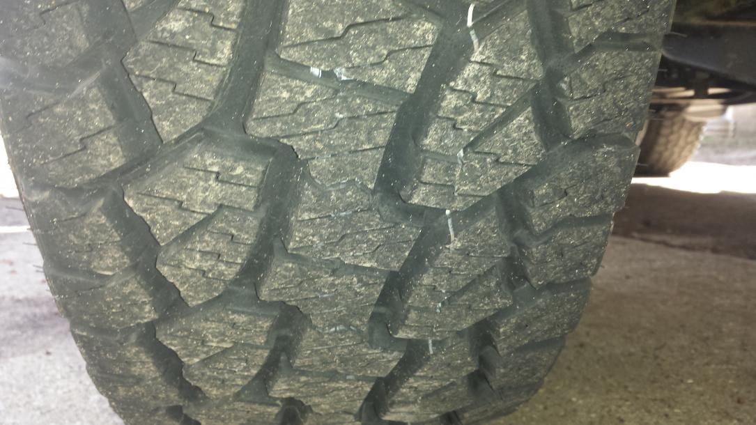

Post some pix of the tires and the tread in good light.

Here are the pictures.
Did the best I could. ..lol
rear drivers tire band new
Rear passengers tire rotated from front
Both front tires are rotated from back.
Chris

They don't "look" feathered or cupped form the pix but the only way to tell is with your hands.
Read hummerz post he linked to above. You will be able to feel it when you run the palm of your hand in the opposite direction of the tires forward rotation.

We drove Happy yesterday and the road noise is still quite pronounced even after cleaning the slide pins and lube n them. The tire test seems fine. The tires are in good shape.
