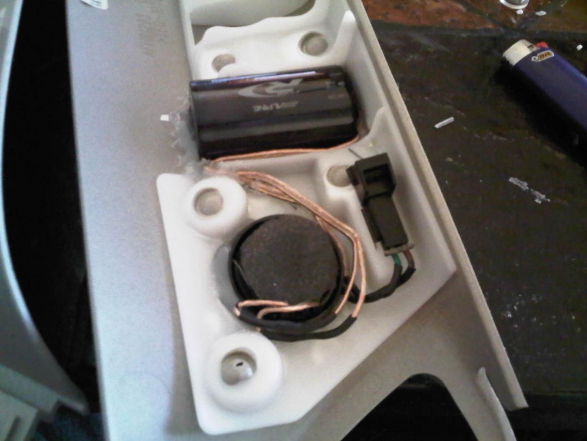

I'm all about saving effort ha ha....I thought it would be easiest. I would cheerfully mount the crossover somewhere else I'd need to tie into the speaker wire harness somewhere, right? How did you find the right speaker wire before it enters the door? Also...how did you fit the crossover into the pillar area? I wouldn't think it would fit.

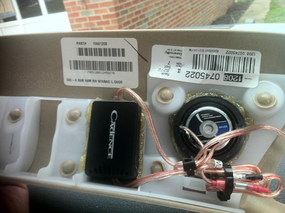

If you can wait until after work I'll pull my A Pillar cover and take a picture. Stand alone tweeters tend to have smaller crossovers than component systems. My Cadence tweeters, even though they are 28mm and handle a TON of power have extremely simple crossovers.
The crossover itself is about two inches long by an inch wide. The inside of the cover has a white plastic support piece to make it sturdier. There are rectangular notches in the white plastic piece, that are almost big enough to fit my crossovers. I trimmed out a plastic piece to open one end of the rectangle, slide the crossover in, and hot glued the crossover and tweeter down.
The tweeter was easy too, just cut out the white plastic part with the holder for the OEM tweeter with a hole saw, and left the outside part that you see intact, looks totally factory still.
The best way to "find" speaker wires is to make a "pop" tester. It's really simple, take a large D or C battery, and tape a wire to each end. If you touch both ends of the pop tester wire to both speaker wires it makes the speaker "pop" or produce static so you can find the right wires for each speaker. I basically just took some wire strippers, stripped a small section somewhere in the middle of the wires, and pop tested them.
One word of caution about a pop tester, I've never had it happen yet, but you do run the risk of shorting something if you're trying to pop test something that isn't a speaker wire, so you should be fairly sure before you try at. At least in our trucks, and most other vehicles, the speaker wires will be twisted together, and fairly thicker than other wires you're seeing. Make sure if you strip something and pop test it you cover it back up with electrical tape if you're not going to use it so you don't short anything!
Yes, yes, I know there are speaker wire colors floating around, but I'll tell you right now they're not worth a ****, or at least were not to me. Maybe 60-80% of the time the colors would be right, but there was always one or two off that were different colors, and I even had colors that were from both the monsoon and base systems, don't ask me, it damn near drove me crazy. Maybe the colors are like the chart says back at the amp, but up at the doors and in the wiring loom going to the back, no frigging way.
I have an 08 Alpha w/ Monsoon so the information I'm about to give may not apply, or it may, I have no way to be sure and have only gotten into my trucks wiring looms, not other years or models.
The front driver side speaker wire is tan and grey. The front passenger speaker wire is dark green and light green. I don't remember which is positive and negative, use a volt meter to be sure. The one thing that took me so long to get sorted out, is apparently the front doors both run down the same side of the vehicle. Seriously, wtf is up with that? You should find speaker wire for both front doors in your front driver side kick panel. You can also splice in under the plastic piece that runs along the bottom of the driver door, but I went to the kick panel because you have far more room to work with, and it was easier to fit things like crimp caps and whatnot in there.

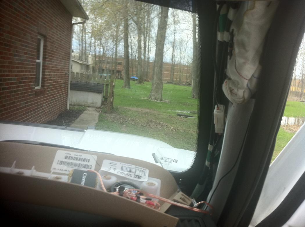

Here's the tweeter's mounted. Don't laugh at my sparkly hot glue, it's all I had on hand and no one will ever see it! Jerks.
You can see where I had to cut the tab out to fit the crossover, because there's one just like it next to the crossover. If you do mount it, make sure its not in the way of the airbag, you don't want to get shot in the face with a crossover.

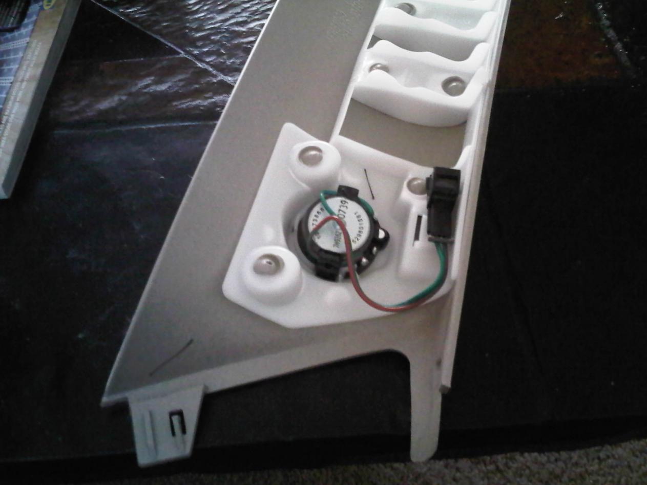

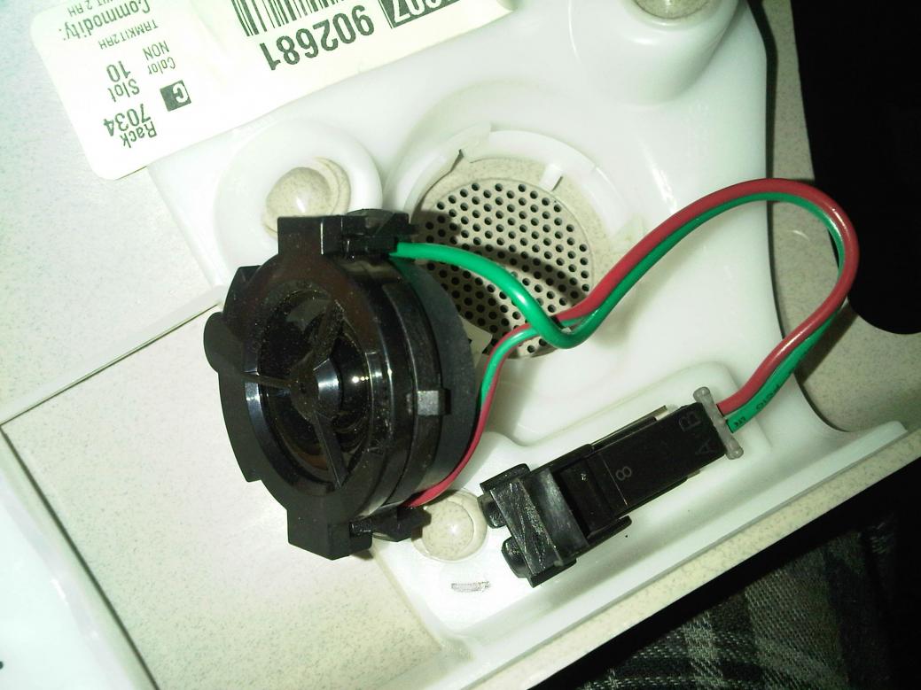

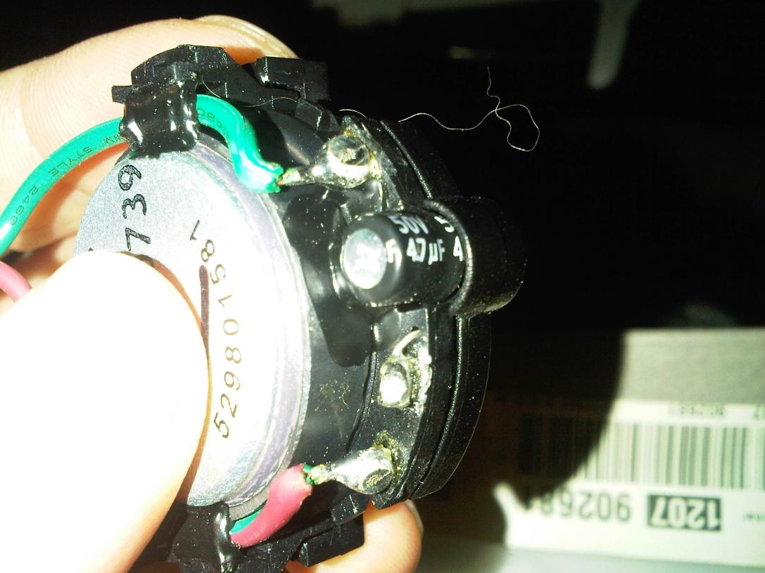

I could be wrong, but this looks like and el cheapo crossover right on the monsoon tweeters themselves. Right?
Old Jan 13, 2012 | 11:20 PM
Yes, but it's not really a crossover but more of a "limiter" or "filter" of the lower frequencies on the bandwith.

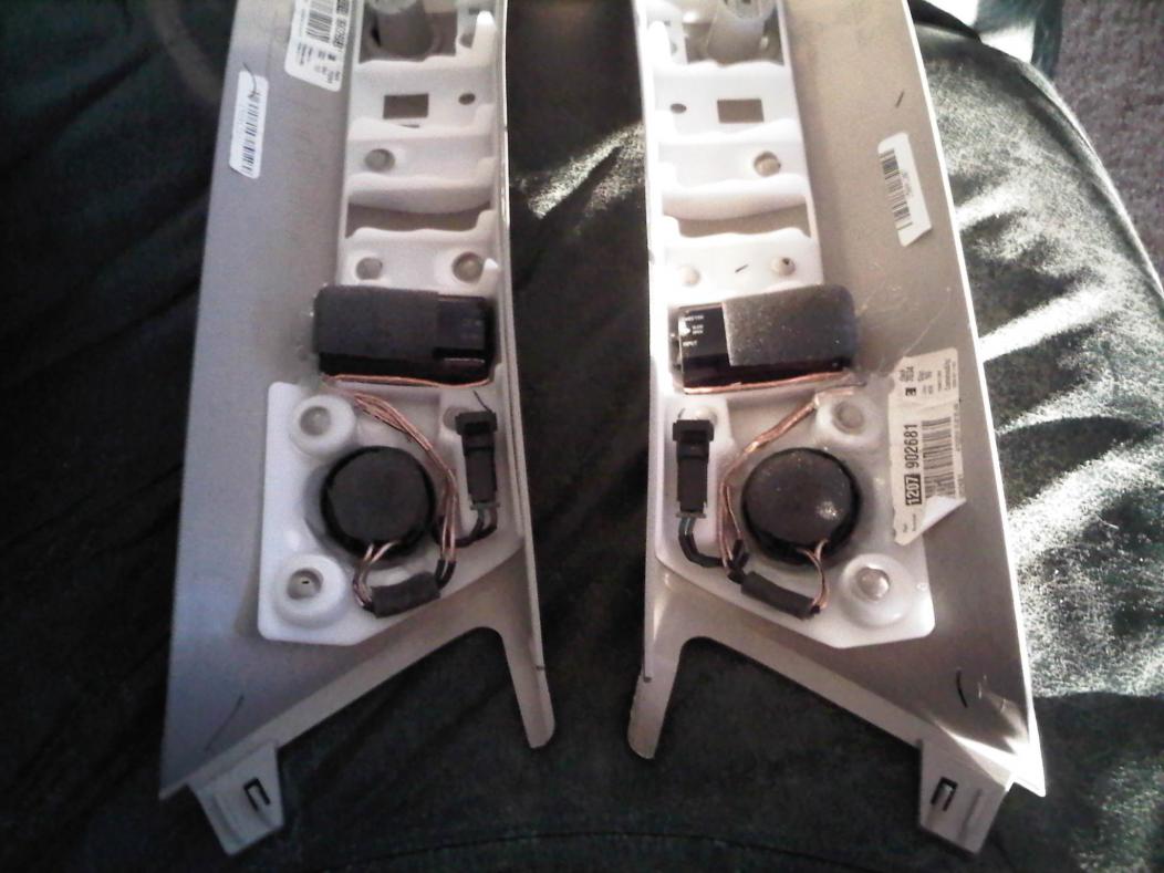

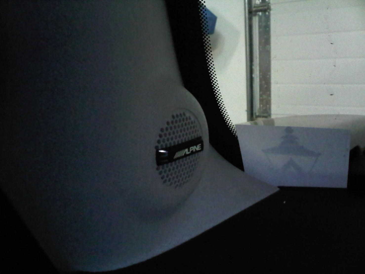

...AKA a cheaper version of a crossover just for the tweeter. Anyway here are some pics of my install similar to Draketh's. Alpine SPR-10TW tweeters. I would recommend these to anyone that wants to keep their system mostly stock but want's to be able to turn it up louder without the factory Monsoon tweeters starting to crackle and pop like a bowl of Rice Crispies. They sound great too and have a broad frequency coverage. Gluing all this stuff in is pretty much the only way to go with this tweeter setup, used a hot glue gun for mine.
Alpine Electronics of America, Inc.
Any of you guys getting a component set wondering how to wire the fronts...personally I would wire in the crossover that comes with JUST to the factory tweeter leads and to the new tweeters, forget about wiring it to the door speakers. Use the factory wire leads to do the door speakers. You don't really need to hook up a crossover to the woofers anyway as generally it just cuts the high frequencies out to them. They can handle high frequency input, they just won't reproduce it. My 2 cents anyway.
Attached Thumbnails Tweeter installation?-img00714-20120113-1050.jpg   Tweeter installation?-img00715-20120113-1052.jpg   Tweeter installation?-img00722-20120113-1534.jpg   Tweeter installation?-img00724-20120113-1552.jpg   Tweeter installation?-img00728-20120113-1618.jpg
