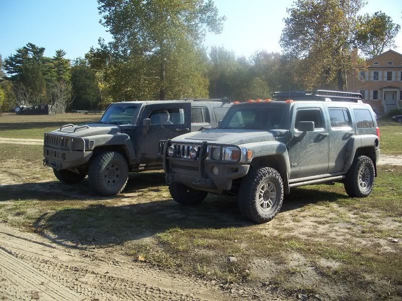

Here's a shot of DAGKANA's truck on 35's on the left & my truck on 33's on the right. We both have OEM 16" wheels. Both trucks are T-bar cranked to about 23 1/2".
Old Dec 8, 2010 | 12:47 PM
donkttu's Avatar
Joined: Dec 2010
Posts: 43
From: Frisco, TX
Bunger - thx for the lesson!
Now, one step further (I won't be afraid to ask another dumb question)...will 33x12.50 R16's fit my stock 16" chrome wheel? With no modification?
With them being taller and wider then what I have now (265/75 R16) I assume I should expect to see a decrease in gas mileage, maybe some rubbing on the front at full lock but what about a feeling of even less power (b/c of the weight and size)?
The root of my questions comes from finding a good deal on a set of BFG KM2 MT's.
Thanks again!
