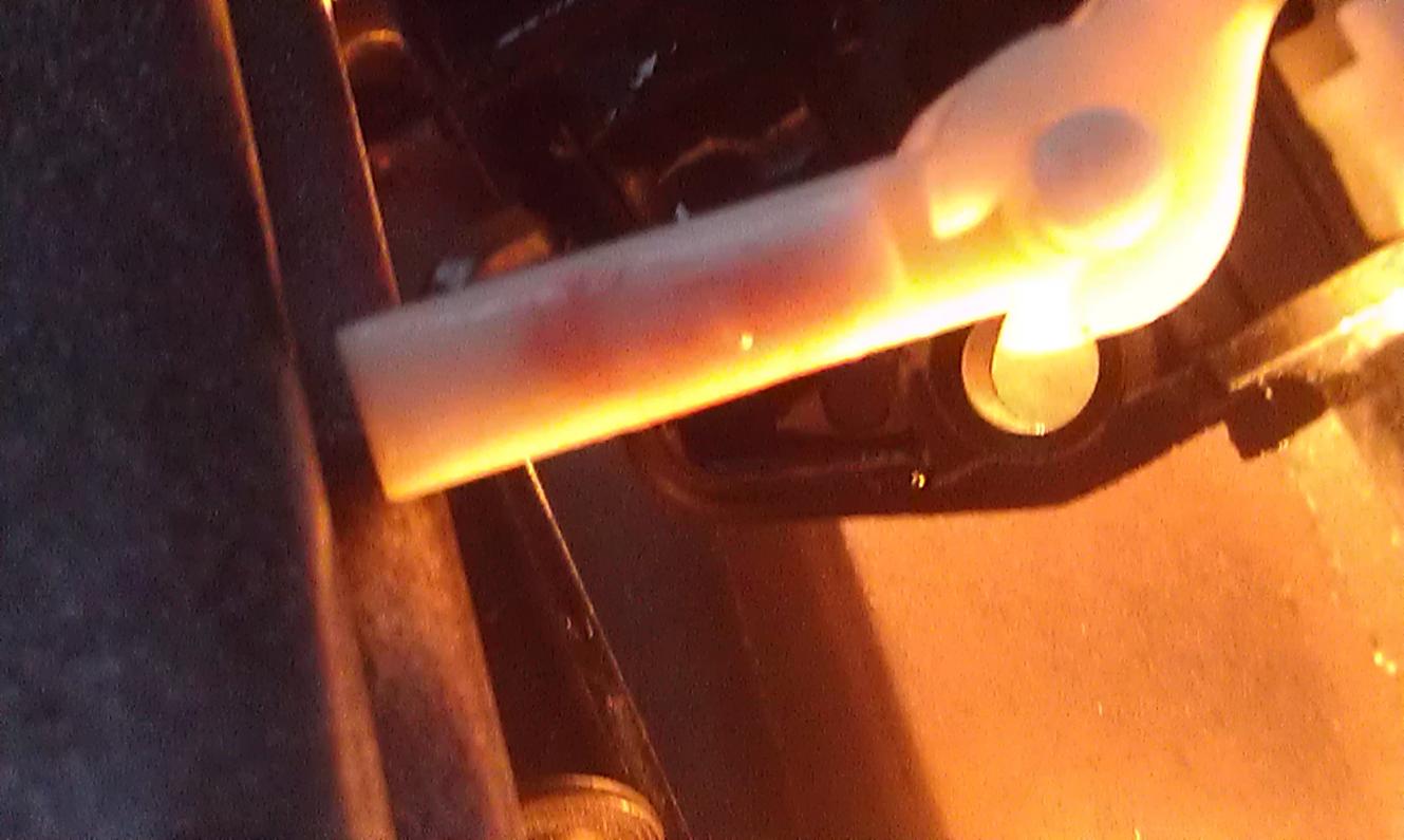

thanks,its getting worse and I'm a long way from home.Both issues are starting to be a pain.checked the wiring to the shifter dont see anything wrong.maybe the switch with the button is going bad??

Finally solved the problem!! the previous owner spilled cherry soda down the shifter. In the mornings it was real sticky until it warmed up enough to work right.i took apart the lockout solenoid and cleaned it.It functions perfectly now.And the key comes out of the ignition too.

Default Lock out solenoid pics
here are pics of the mess.
