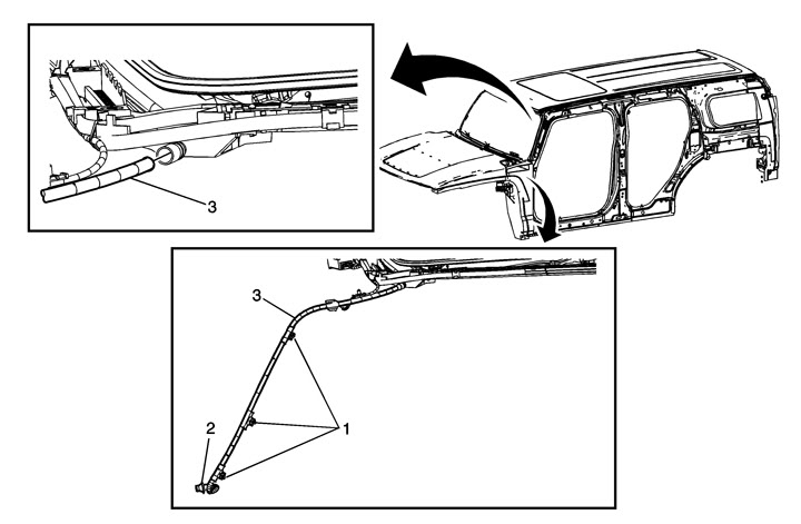

See the small square? The drain runs inside that square. Item 3 below is the hose.
h3 trim.
rear drains
NOTE: The above procedure is only applicable to factory-installed sunroofs and IS NOT applicable if you have an aftermarket sunroof installed, as the drain hoses are generally routed slightly differently.

The piece that number 3 hooks onto in the last pic posted above is the cup i fixed.
