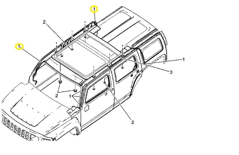

I would try to use air, pipe cleaner, wire, weed eater cord, etc, to unclog your drains before going to a dealership. The drain tubes themselves are less than $6 per corner, but it's the headliner removal, windshield garnish removal, upper quarter trims, and lower quarter trims where the dealership sticks it to you. The "1's" are your drain tubes.
