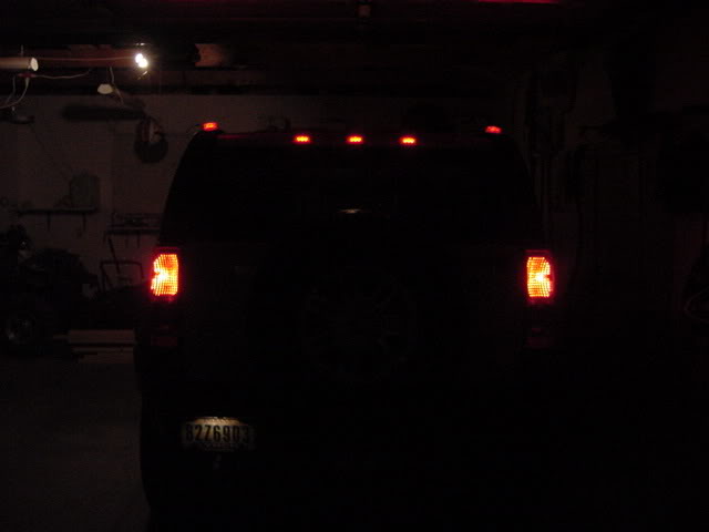

Well I managed to Install my rear marker lights and the Off road light bar. I even added 2 market lights to the light bar and have the wiring ready ro install the 2 outside front marker lights as soon as they arrive. The only issue I'm still having is I have run the wiring for the front marker lights to the engine compartment and now I need to find the tail lamp wires, anyone have any suggestions ?

ORIGINAL: bonzaiii
For the rear, I would tap into the trailer wire harness.. i have heard people are blowing fuses trying to tie into the tail lamp wires. (I have mine running through the trailer harness.)
The fronts, Take off the a pillar on either side and run the wire behind it. Thats how the factory marker lights have you run the wires..

As for the front wires I di run them down the pilar but cannot find the wire that goes to the trailer hitch in the engine compartment.

I think if you want to look for some wires off the front, I think the best bet might be to either pull them from the front side marker lights (wires hard to get at though) or use the pre-installed "empty" wires running through the front firewall, and just pull some current off the light wires behind the stereo...
I think the risk of blowing a fuse is pretty low if you stick to LEDs because of their extremely low current draw (5 LEDs each drawing 0.05A only takes a total of 0.25A which works out to abt 0.6W, much less than a bulb)... if you do use bulbs, I would be really careful... Someone who installed their own factory marker lights could probably tell you where to pull the power from, just do the same thing...

Man those lights look great! You had to drill a hole where the rear lights go?

Yea, I actually had to drill 3 holes per light. I installed the light bar in front first which required drilling some rather LARGE holes so by the time I got to the back my hands and knees had pretty much quit shaking.
