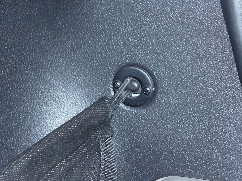

Wasn't there a post on here somewhere or a picture where someone had taken some washers or fender washers and screwed them in place to help support the hangers?? I remember seeing it somewhere....
I believe it was Paladine71 that did a thread on reinforcing the attach points but I'm not sure which forum it was on.
Old Sep 23, 2011 | 10:44 AM
It was James. It's a great "fix"!
At Brodie's (theBroken) suggestion, I made a simple adjustment. I went to the garage and found two washers of equal diameter to the holders and drilled holes on either side of them:
It was then a simple matter to line up two screws and drill them through the factory holders. Making a very solid holder that will not easily pull loose.
