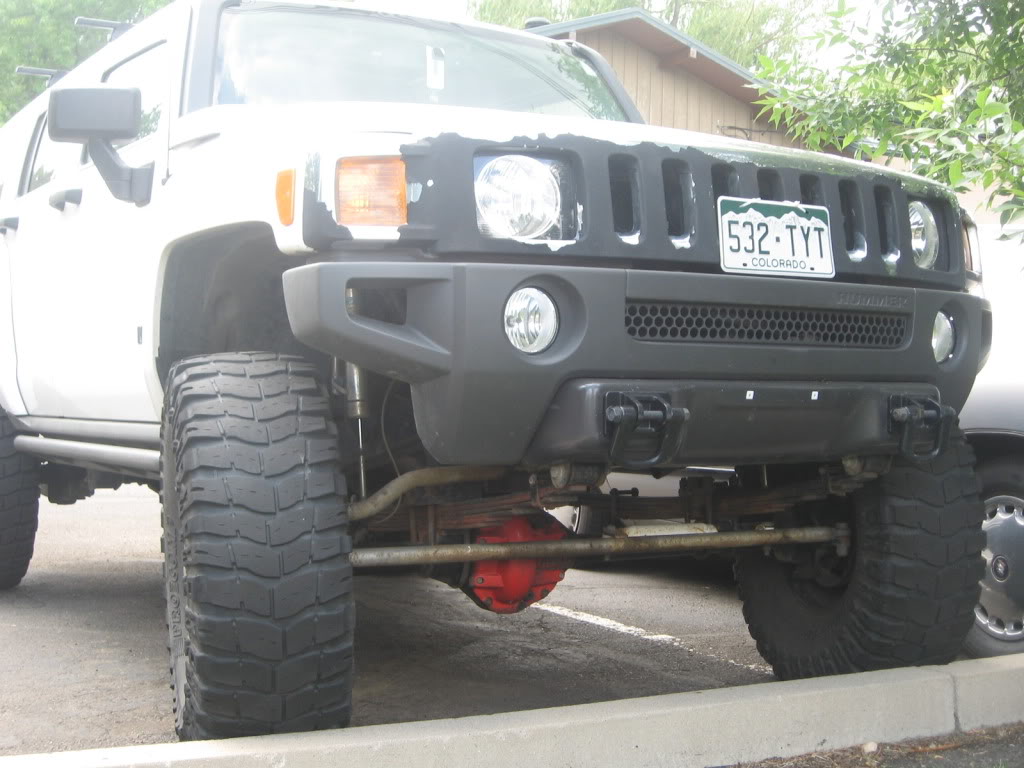

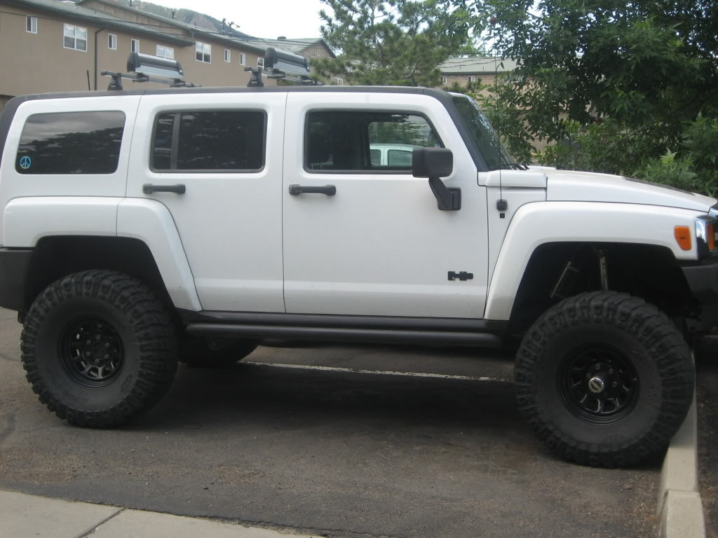

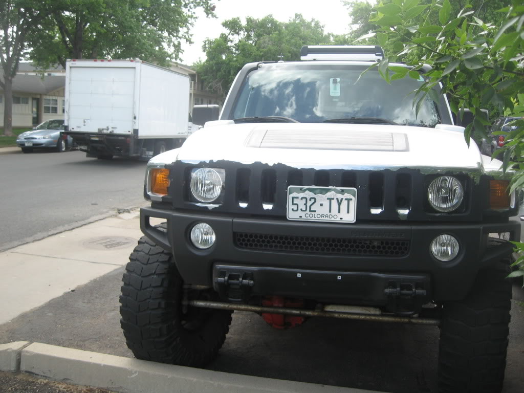

Nothing says affordable like a leaf sprung Dana 44

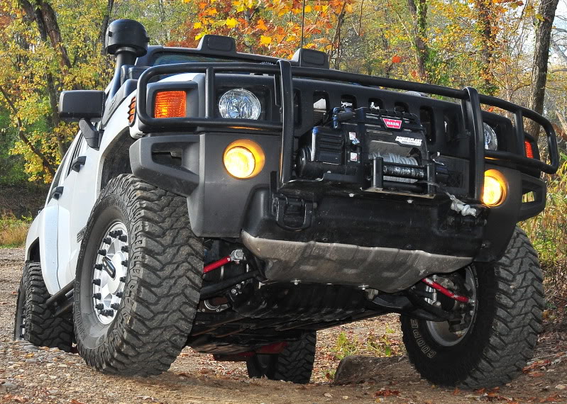

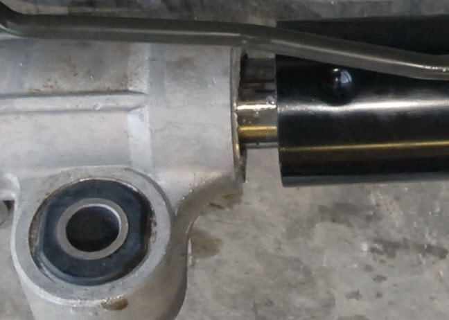

With the BP tie rods you are not just replacing the stock ones with beefed up tie rods, like those with sleeves. Because of the added articulation up and down and the ability for the Heims to rotate and take stress off the rack they should help absorb the stress the OEM put on the rack hitting the limits and having to flex the tie rod itself, which usually results in bending or breaking. With the bend in the outer end it centers the Heim at rest so you get max use of that as well as reducing the upward force OEM apply when at a steep angle after cranking up the t-bars.
I added longer anti-sway bar links to keep those from maxing out as well with just 23 1/2 or torsion lift at full droop the stock ones, with longer shocks are maxed out and cocked up as far as they can move.
Beefing up and preventing movement on the passenger side will also reduce the rack flex that can break the other end at the steering shaft aluminum casting with either tie rod. I decided it takes both mods.
I too have concern about beefing up the CV's even with a CI diff, but still have considered it after hearing about the number of people popping those. I do carry a couple of OEM CV's!
After having a Pusher front end on my Toyota I sort of like the slik front end on the H3. I guess it's different strokes ........and adjusted driving techniques and and some mods to increase reliability on the H3 as well as your intended type of wheeling. I plowed lots of furrows with that pumpkin on logging roads already messed up and was usually the cause of being able to go forward.
