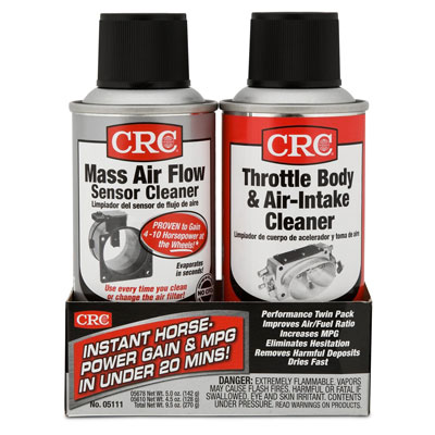

600rpm's is good,
1-Clean maf sensor with crc mass air flow sensor cleaner(let it thoroughly dry before reinstallation)
2-Pull and thoroughly clean the throttle body (crc throttle body & air intake
cleaner)
3-Add a bottle of techron to the tank along with a top tier fuel.
