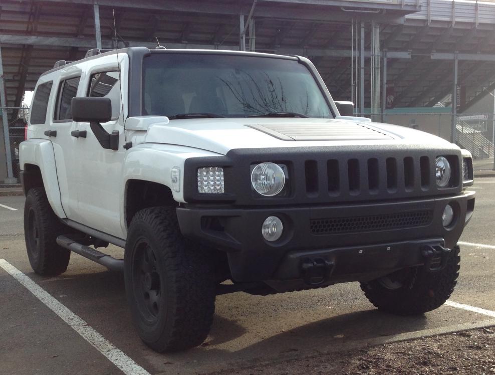

So I went crazy this morning and went a totally different direction, but all of these suggestions helped immensely. I looked up the local Line-X dealer and it's currently being Line-X'd. I saw an example of somebody else that did this and, knowing I will never go back to chrome, this seemed like a durable, high quality, great looking solution.
I will take pics once it's done for those that may be interested. Cost was $60.

Here it is! I changed the turn signals to clear LED units, so it looks even more different than it did prior to LineX... but you'll get the idea.
There's definitely a texture difference between Plastidip and LineX (the Plastidip was more similar to the bumper than the LineX), but I still like the look. Some people might prefer to LineX the bumper as well.
