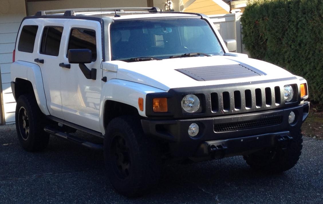

So, I plastidipped my grille a few weeks ago and I was so happy with the results. It looked great and seemed very durable. However, after only 1.5-2 weeks, I noticed it had peeled and torn off of one side of the grille... then I noticed it was delaminating at the top edge and in every grille opening as well.
What did I do wrong? Do I need to sand first? Do I need to include the backside as part of the coat so there is no edge?
I'm including pics to help with diagnosis.

By the way, in the "after" picture (before the peeling), it looks like there are bubbles/spots on the grille but there were not. That's just a trick of the lighting somehow. It was sunny for like a week or more after the application (albeit very cold, maybe 15 degrees F).

That is where you went wrong, to cold. Spray both sides, and item must be clean of all oil and dirt.

it looks like you had either oil or major temp flex during or immediately after spraying. Make sure you clean very well, no oil what so ever, just in case you used a tar and bug cleaner or polish in the past. I'd suggest going to autozone or similar and buy some stuff called "prep-all" or similar, it'll be by the auto body stuff and do a good cleaning with that, then make sure you have the grill at at least 70 degrees and it has been that way for a little time, thn spray in low humidity, let dry and redcoat a few more times, then let it fully dry a few hours before driving or exposing to any major temp changes.

oh and also make sure you start with a light dust coat and gradually build, don't go for full coverage on one coat.

Agree, you need to do multiple LIGHT coats.
I've plastidipped many things with great results.
Also DO NOT sand the grill. Plastidip is made to be able to be removed later if you change your mind, without damaging the base paint or plating.

I think it was maybe about 18 degrees when I applied it, but it warmed back up into the 30s-40s in the week or two following.
We cleaned the hell out of the grille with glass cleaner until it was totally free of any visible dirt, bugs, etc.
Any comments on driving around with the grille off? Any reason this is a bad idea? Sounds like I should let it dry inside since 40 is the high around here for the next few months.
