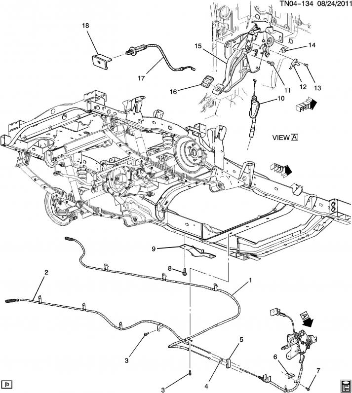

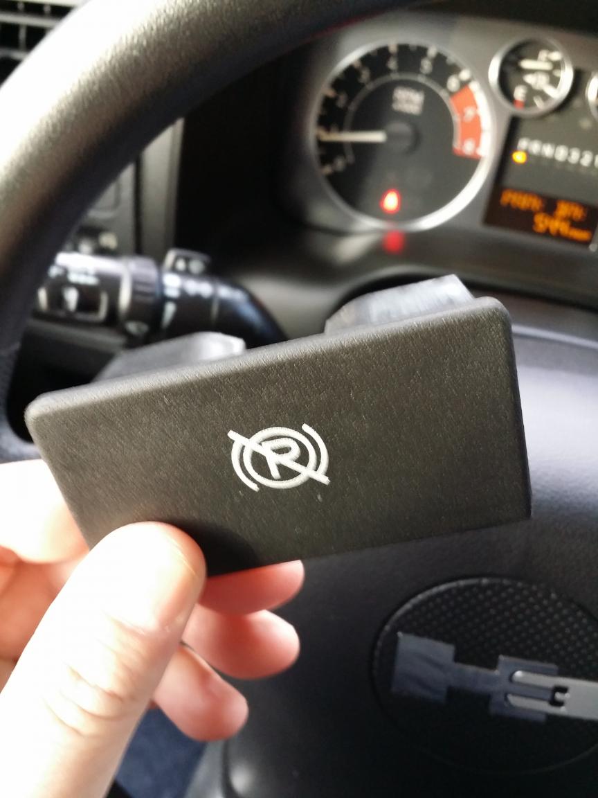

So it's colder than usual and I was getting in my car to goto the office this morning and I pulled the parking brake lever and flew back into my seat with the lever in my hand.
It looks like a pretty clean break and the tip of the plastic from the part (cable?) still in the lever.
I have an '06 H3. Does anyone know what part(s) and their part # of what I need to order? Part 17 in diagram?
Thank you very much in advance-
Eric

nm...
CABLE,PARK BRK REL(04.779)(ACDelco #25792420). CABLE-HANDLE, Parking Brake Release. For: N1(06) (2006-2006) (2006 - 2006). Required: 01

I haven't seen a thread on the parking brake handle breaking in about 4 years! Thanks for not asking about tires The same thing happened to me years back when it was new. Apparently the square handle just presses onto a plastic deal on the cable. Give it a try pushing it back on. Just don't pull on it too hard next time. HTH.

I ordered the cable. the plastic from the male end of the cable cracked off inside the lever.
