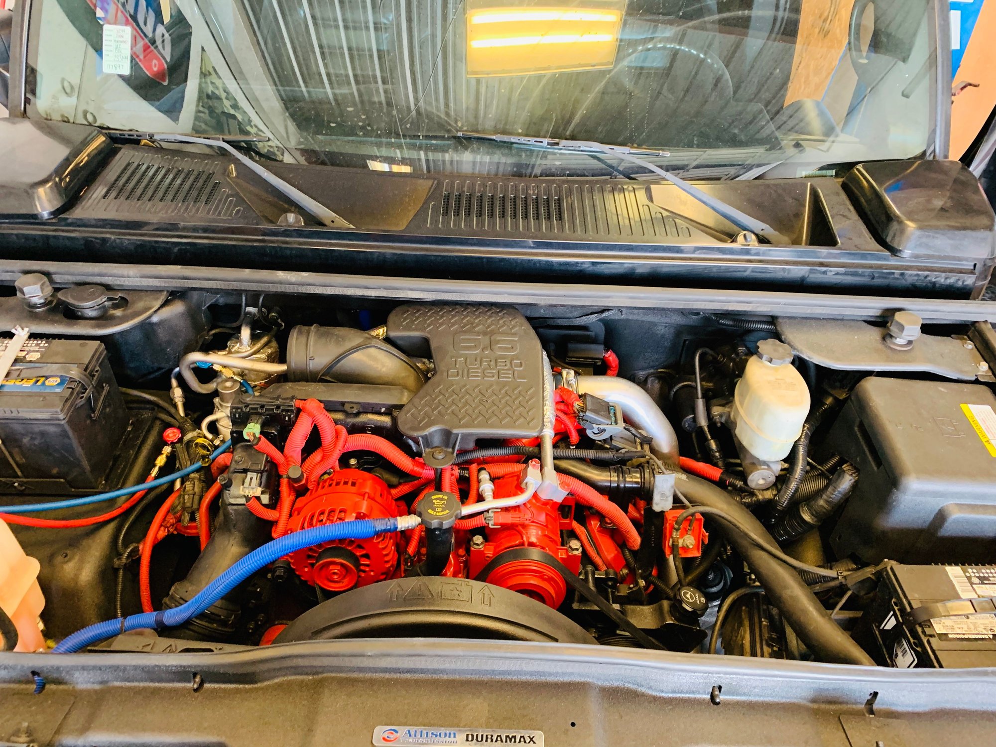

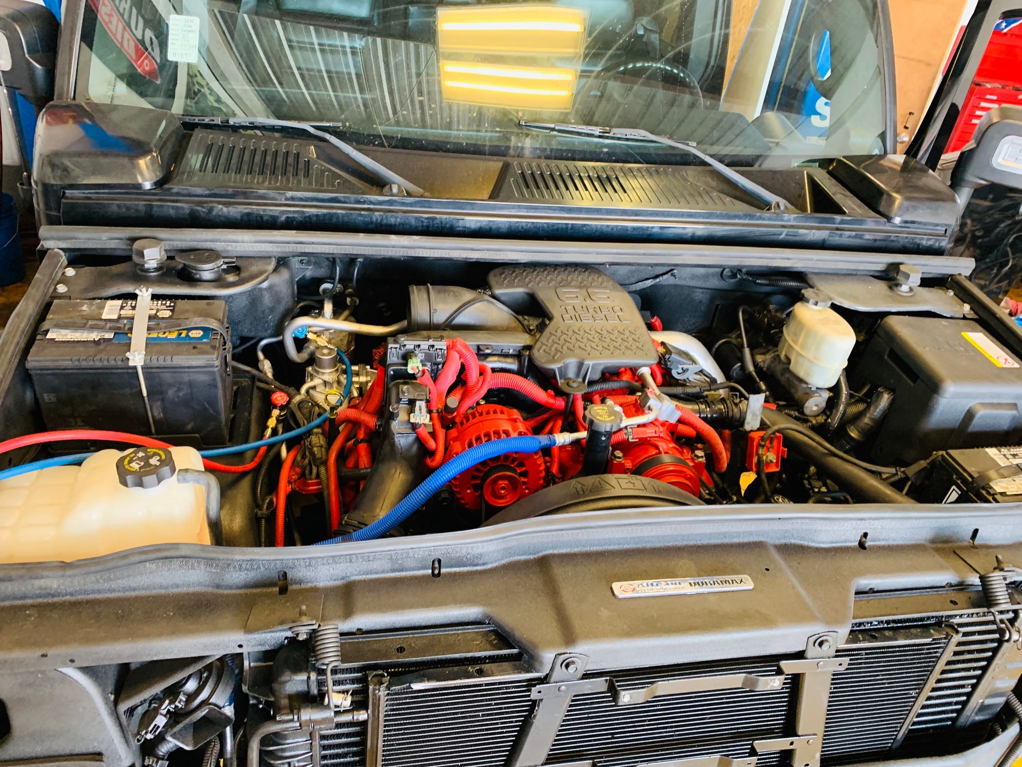

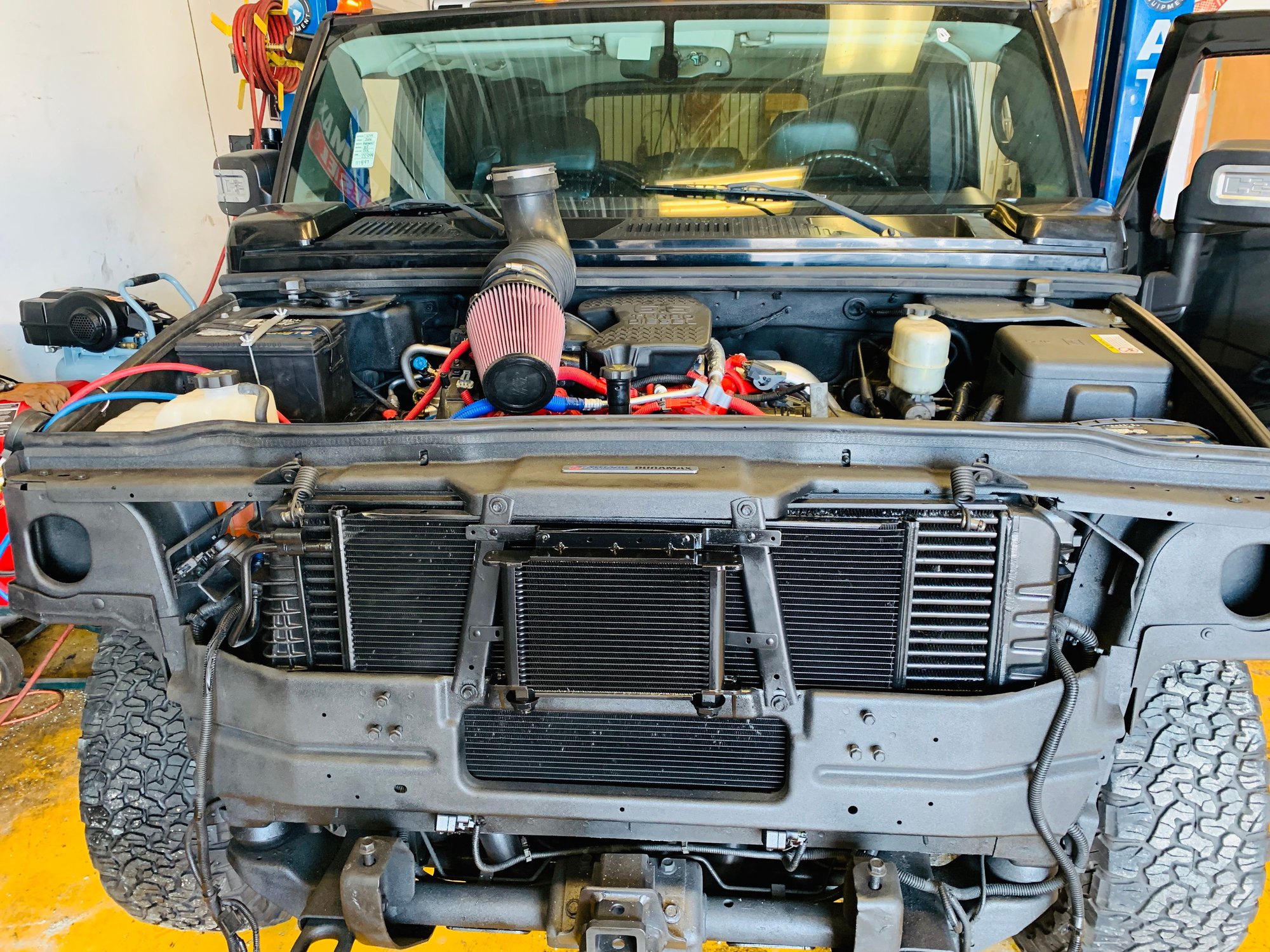

32 hours in. Driveshafts, transcooler, wiring, pcm tuning all done. Skid plates on. Waiting
on diesel cluster, trans lines, Trans filter. Freon and I’ll be driving by end of day.
Probly going to be changing the transfer case encoder motor. It’s stuck between 4 high and 2wd

39 hours in. She’s running, ice cold a/c. Conversion is done.
only thing left on truck is a headlight that never showed in mail. And a transfer case encoder motor, She has me stuck in 4 low. And a bad #1 crash sensor that I ordered. And waiting on the diesel gauge cluster I sent in mail. All easy.
