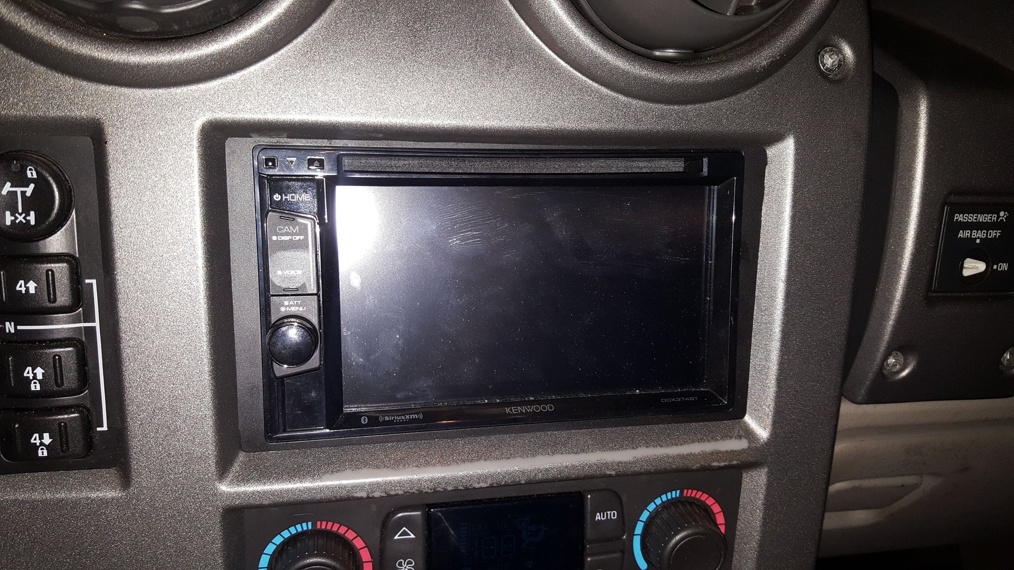

I used a Kenwood head unit with the metra axxess wiring harness and steering wheel retaining module. I kept the factory speakers and amp and I feel like I have pretty good sound. You'll find that installing the stuff is the easy part once you get started. The hard/annoying part is disassembling the entire dash just to get the head unit out. You have to use the patience of a brain surgeon to get the door panels off if you're putting in new speakers. If you break one of your door panels your wallet is in for a world of hurt.

did you have to get an install/ dash kit kit for the installation of your head units.
I have heard that when installing aftermarket headunits you need a installation kit, but then when I was looking at the dash piece, it almost looks as if it might cover up the headunit without an install kit.

You'll definitely need something to go around or you'll have gaps all over. I have a black piece of plastic that snaps around the head unit. I believe the kits are less than $10.

Thank Hummer On Fumes. The picture helps alot. So, this kit you got (or that piece of black plastic) is it Hummer specific?
No I believe it is a Metra generic dash kit for GM
"Metra 95-2001 Dash Kit"
