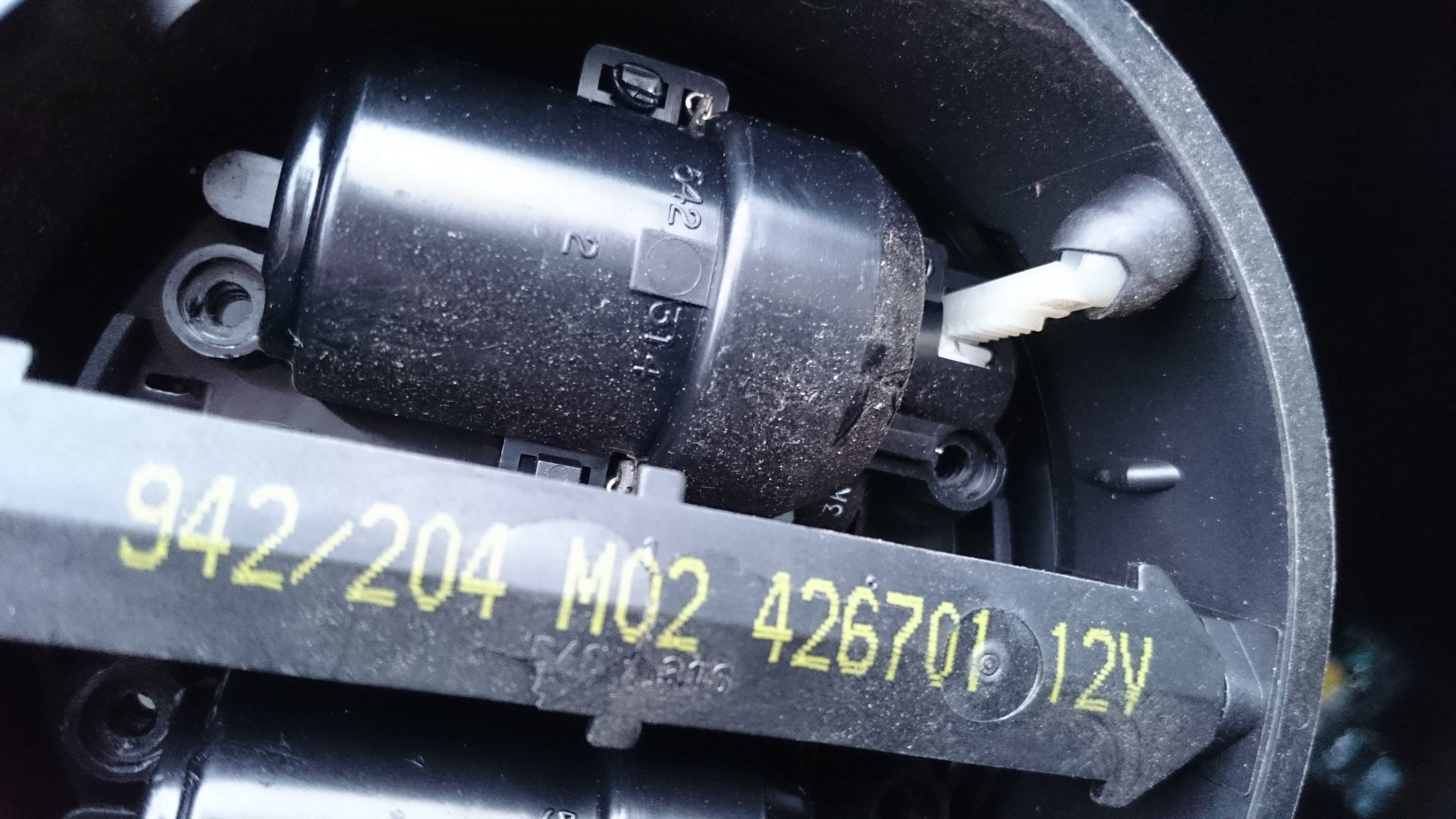

When I said gears its really a rack and pinion type arrangement (see photo) Indeed the mechanisms were tricky to dismantle as they are "plastic" welded.
Unfortunately there are no GM suppliers here in the UK but I will try the US and see if I can get lucky.
