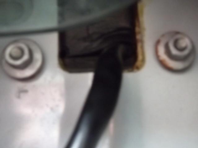

I replaced the drivers side mirror. It's not too bad of a job.
Hardest part is getting the interior door panel off without cracking the plastic.
There are 4 bolts that hold the mirror on. And yes they are acceded from inside the door.

this pic is inside the door
