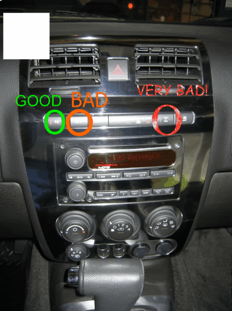

hi i just bought a 2007 H3 and for some reason when i turn doesnt matter which way or forward or back my front wheels seem to catch or drag on the ground and i leave black marks.. this happens all the time somtimes it doesnt and it turns smooth...im thinking there is somthing going on w the all wheel drive but need help.. mechanics say its normal but i dont think shredding ur tires while turning should b normal lol please help thank u

Step #1. get in your vehilce and read the manual!
Step #2. look at the center stack above the radio and make sure your H3 has a light in the farthest left 4x4 control button (4HI Unlocked).
Step #3. If not, press the farthest left button to disengage 4HI lock!
For daily use on NON-wet/NON-Snowy/Non-Muddy/Non-icy roads etc!
If you do NOT have the button that is circled and FLASHING RED then you do not have an Adventure package 2007 H3.
Step #4. If it is in 4HI unlocked (farthest button to the left) then you need to call a dealer or mechanic because you have a 4x4 controler issue.
Hope this helps!
(Note: this is not my chromed out dash, just one I grabbed off of picture pages and midified)

Well now that we know your button is depressed in 4HI (unlocked).
Your t-case actuator could be bad and keeping it in 4HI Loc or you have a buggered up half shaft that does not articulate to the full extent of your turing radius thus causing the "chirping" around corners. I had one of mine "POP" itself back in and had no issues with it since. But that is a rare case!

sounds like a problem that i had about a year ago...right after I bought my 06...i had the tire chewing, and parking lot embarrassing tire chirps...there is a fork mode in the trans that is made out of plastic that melts...i had it replaced on problem solved. i have no idea if the 07"s have the same problem...its worth checkin out. maybe someone else out there can elaborate? just my $0.02
