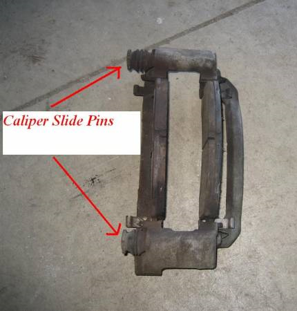

Put some anti seize on your caliper slides......I had this same problem on my Cherokee after driving through a bunch of water.
