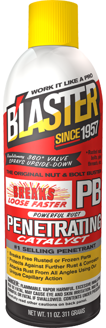

Obviously, the camber and toe are F'd up! Get yourself a can of Pb Blaster and start soaking the bolts and cams. Loosen them up before you go back for an alignment. Most alignment techs complain all the time, and many will use a gas wrench which will destroy the bushings. Btw, I hope you meant 3" and 2" on the lift?
