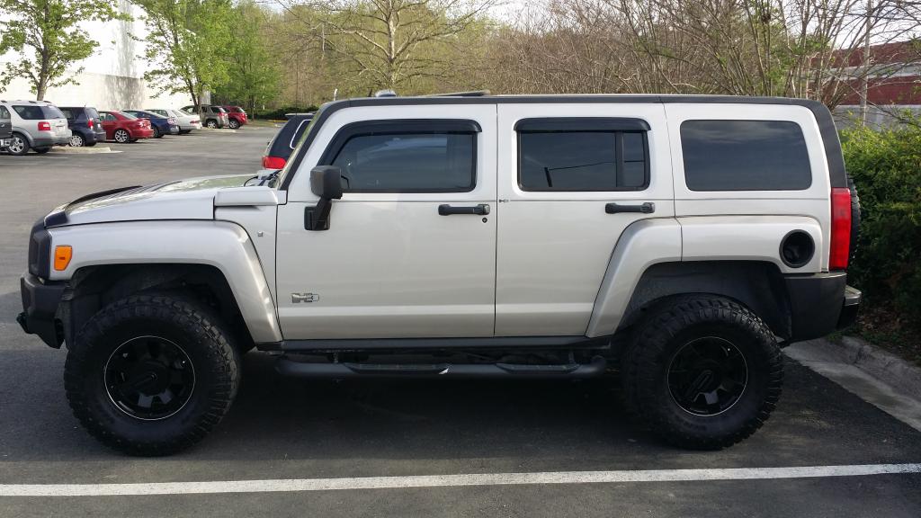

I will get another "crank" to 23.5 (and alignment) and live with the results. i'm gonna put a roof rack on so maybe that will drop the back a little..
*ps, i "tilted" the camera on this photo so you cannot really see as much sag... but look at the parking lines and the difference in fender gap.
thanks people!

Are your nerf bars bent, or is that an illusion? Looks like they are lower in the rear than up front.

Good looking truck! I think Bunger may be on to something.... the nerf bars add to your perception that the front is much lower than the rear.
Rock rails would clean that all up.

SEE... WHAT HAD HAD HAPPENED WAS... I went off-road one time, and this big azz rock/boulder was in the way. I got past it though and me and the obstacle went our separate ways. That was literally right after i got the truck.. and I had gone out by myself, so I didnt have any other choice than to get from between a rock and a hard place (pun intended).
RE: the nerf bar... I have been meaning to get that replaced. I suppose it does add to the perception of more sag in my front. hmmm... who has nfab steps for sale? LOL!

That's exactly why everyone who seriously wheels offroad REMOVES the nerf bars.
They can get damaged, but worse, they can CAUSE damage. I have seen one bent back so far that it punctured the rear tire.
I hate nerfs. H3's look better without them.
