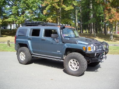

First of all the Rough Country kit is nothing more than a waste of money.
I think most of us have at least some spring sag. I know that I do, but I also carry about 100 lbs of tools and equipment in my truck most of the time.
I have Samco 2" extended shackles on the rear springs, which translated into about a 3/4" increase at the rear axle area.
I also have a 1" body lift.
Here's a picture of mine, just remember the weight I carry. It's pretty level.
