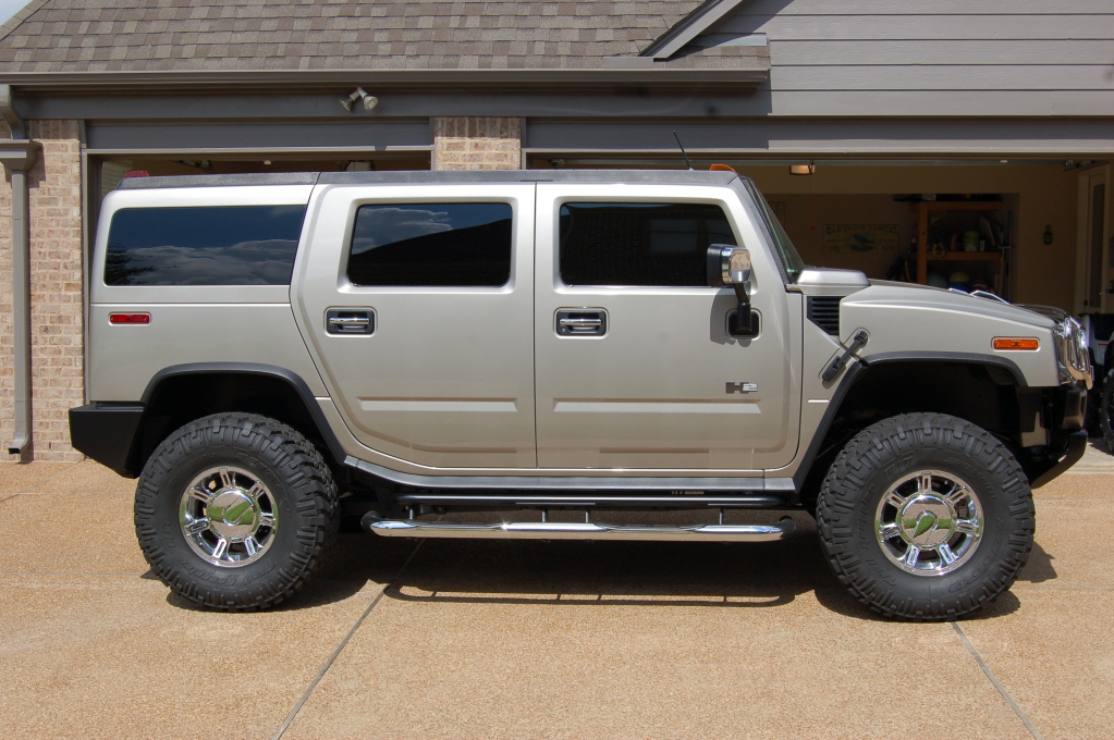

On my '03 H2 with 37" tires, it sits 43.75" from the ground to the black moulding over each wheel well. I'm raised using the factory keys. I thought it was level until I stood back and realized the front wheel wells go about 1-1.5" higher than the rear so, in reality I'm still sitting a bit low in the front. I just got some 3" lift keys and the tb compression tool. I was wondering if others that have leveled theirs have the front sitting about 1"-1.5" higher than the rear to compensate for the higher wheels wells in the front?
Thanks,
Todd

The picture I attached is with the factory keys maxed out. What I'm saying is that the fender design has the rear fenders about 1.5" lower than the front fender(from the ground). I thought I had it level with all 4 corners at 43.75" but, then realized the fenders are different from the front to the rear. I'm going to install the keys tomorrow and raise the front up another 1"-1.5" to see if it truly sits level now.
Thanks,
Todd

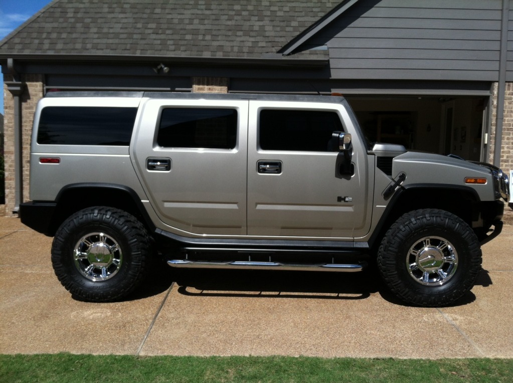

I added the keys. and there is a ton of room to lift the front now. I have it set at 45" in the front and 43.75" in the rear. I believe the H2 is truly "leveled" now.
Here is an after shot:
