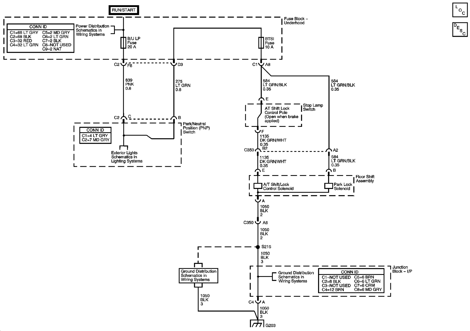

Old Aug 17, 2016 | 06:03 PM
HUMTECH's Avatar
Joined: Mar 2016
Posts: 190
Key does not come out unless brake pedal applied-h2ignlock.gif heres the ign lock schematic

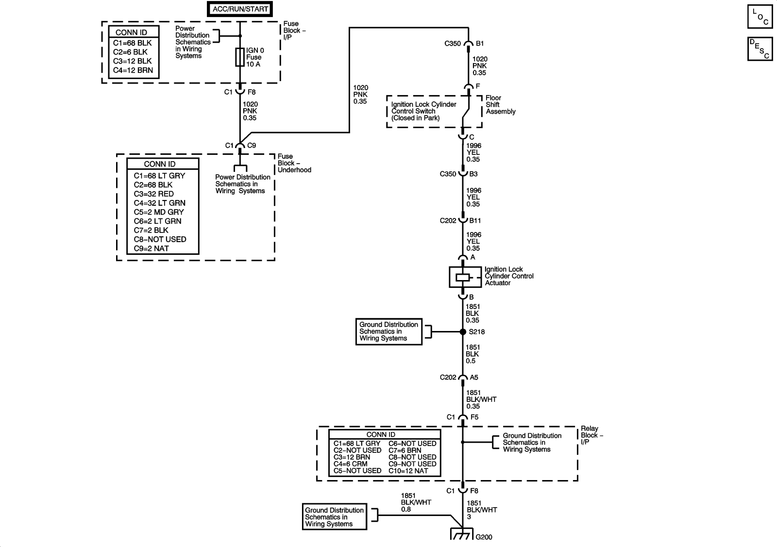

Old Aug 17, 2016 | 06:05 PM
HUMTECH's Avatar
Joined: Mar 2016
Posts: 190
Key does not come out unless brake pedal applied-h2shiftlock.gifheres the shift lock
