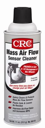

Do you know what a MAF is???????
$12.00 would have fixed you up. Basically $6.00 each.
Size:  17.4 KBName:  3MTPlatecleaner.jpg
Your sensor might have got dirty, and it could even go bad like any other sensor or electronic part. Filter oil and adhereing dirt cannot ruin a MAF.
A new sensor is $71.35 http://www.autopart.com/MAFS/MAFS2004HUMMERH2.htm
