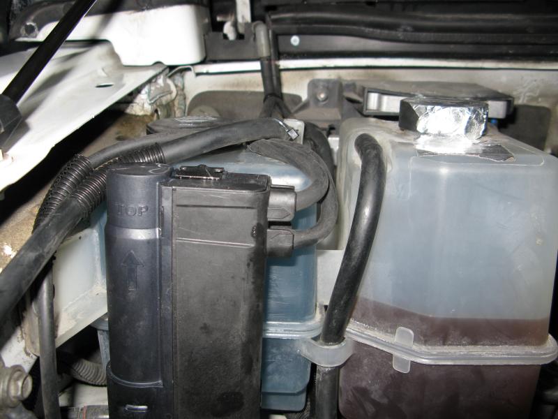

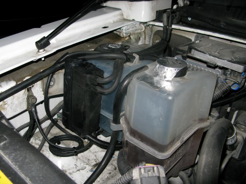

Just installed Alpha Therm Heated Wash unit. I also installed the necessary 60/80A relay to prevent constant ON when battery is connected to a charger. It will only work when the engine is running and the battery voltage is 13.0V and up.
