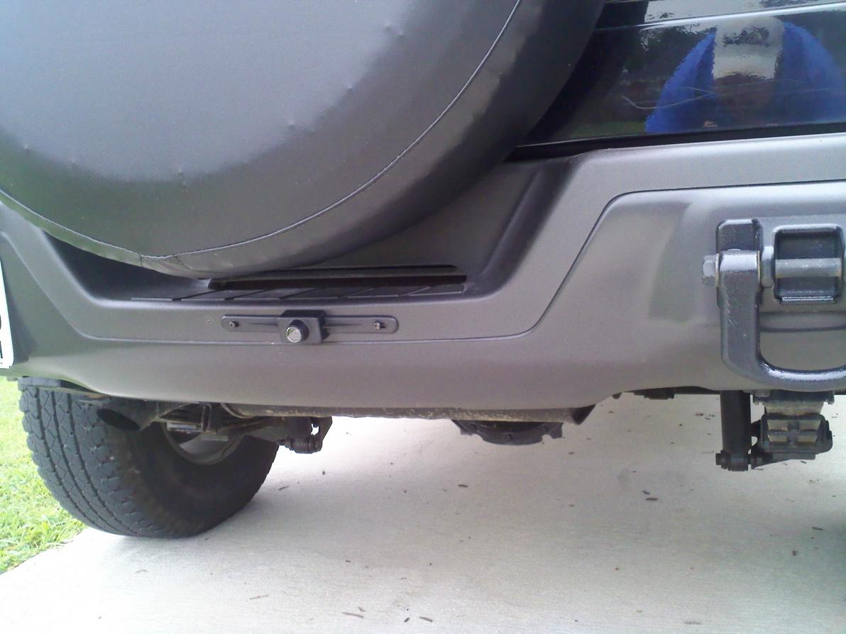

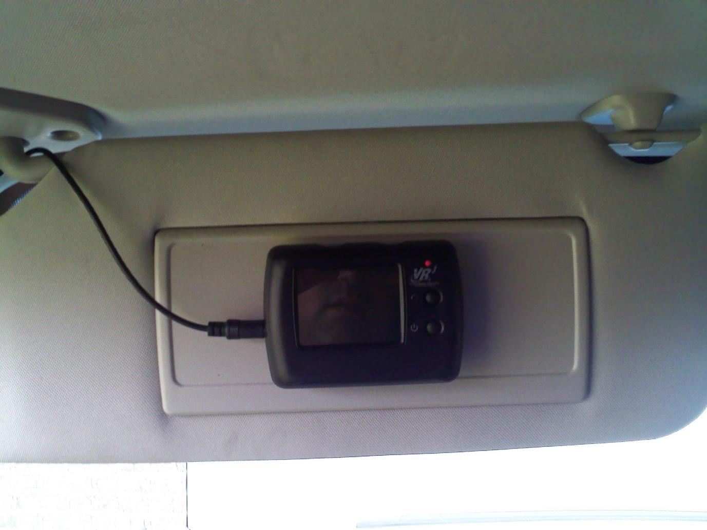

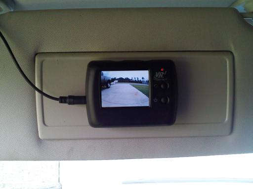

I wired the camera to the reverse lights so that it only works when you put the vehicle in reverse. The signal is sent wirelessly to the monitor wich can be mounted on the dash or whereever you want. I put mine on the sun visor so i just close it up when not in use. The monitor can be straight wired to the fuse box(which is how i did mine) or it comes with a cable for hooking into the cigarette lighter(power adaptor thingy). The model is VR3or Virtual RealityVideo Labs. The actual model number is VRBCS300W. Picked it up at Wal-mart for $79. The monitor is 3.5" LCD and the camerea is 2.4ghz wireless. Comes with all the wires and connectors that you need to mount the camera anywhere you choose, I chose right in the middle of the back bumper. YOu can mount it with the liscense plate with NO drilling. I will post pics tomorrow. I know this is not the factory back-up but it works great. I have used it at night in dark areas and in parking lots already and it is well worth the money.

Old Jul 18, 2010 | 03:46 PM
cddutt's Avatar
Joined: Jul 2010
Posts: 54
From: alabama
Default Here are the pics......
