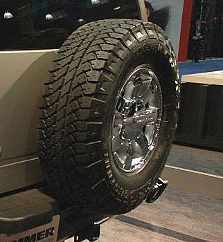

You noticed correctly. Dealerships, epically non hummer dealerships do not list them correctly at all. Typically if they list a "off road package" they are talking about a brush guard or UCP but not a locker. If they list a "adventure package" it may or may not be a adventure package. Easy way to quick check in photo's is to look at the spare tire. If it's a 2006-2009.5 the spare on a adventure will be a Bridgestone Duler AT RHS. The RHS is written small after the 'AT' and hard to see but the easy way to tell that it's a RHS is it will have nice lugs on the side walls. Non adventures, even Alphas that are non adventures will have goodyear wrangler RT/S or Bridgestone Duler AT (non RHS). 1/2 way through 2009 they started putting the crappy Bridgestone's on the non adventures. It's not 100% way to tell but chances are the spare has never been removed off of a H3 with less than 50k.
Here's a dueler AT RHS
http://forum.ih8mud.com/attachment.p...1&d=1118190549
Here's a normal dueler AT non RHS
http://www.tirerack.com/images/tires..._rhs_ci2_l.jpg
Keep in mind the #1 thing with the adventure is not the locker, it's the 4:1 t-case.
