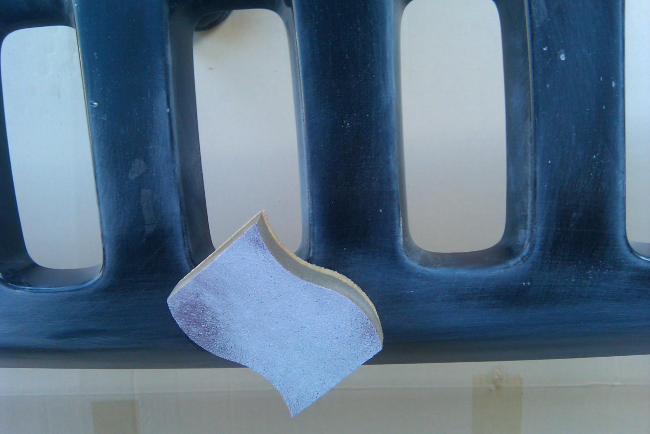

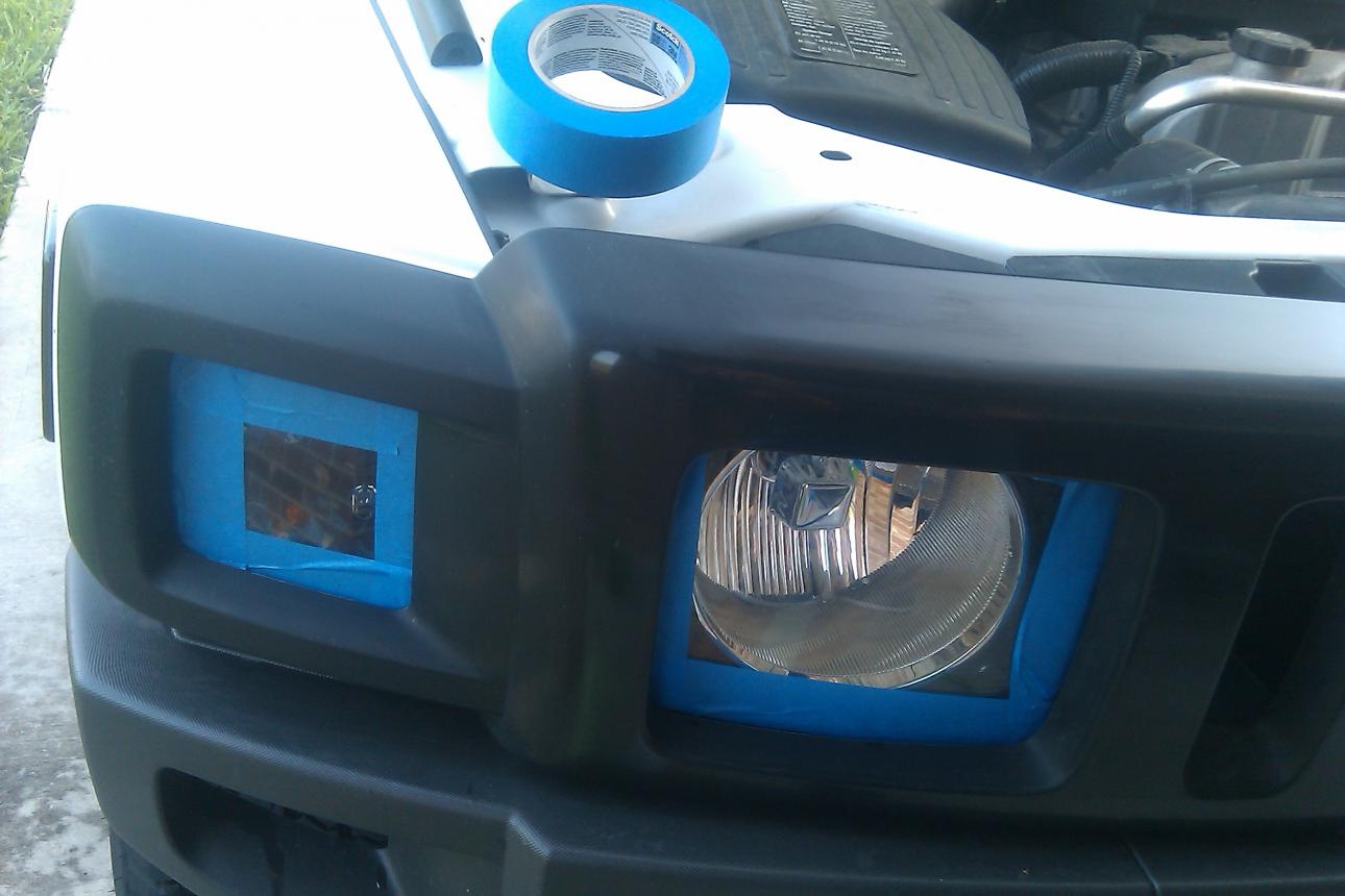

I picked up a used black h3 grill on craigslist a while back that bad a bunch of chips in it. I ended up sanding it down and repainting it. I used a couple spray cans of gloss black enamel. I finished off by wetsanding from 800-2000 grit then using polishing compound to bring back the gloss shine. It was tedious wetsanding it and polishing out the orange peel but the end result was nice. So far it has held up nicely over the past 3 months.
Another option you might consider if you just want an easy way to paint your chrome grille black is to use plastidip $6 a can at home depot. Just spray on about 4+ coats (make sure you clean the grille really well. If you get tired of the black or get ready to return the vehicle you can just peel the plastidip off.
I just plastidipped my rims over the weekend, only time will tell how durable the finish will last. Check out youtube for how-to videos on plastidipping rims.
I have attached some images of my grill, sanded down -> finished product.
