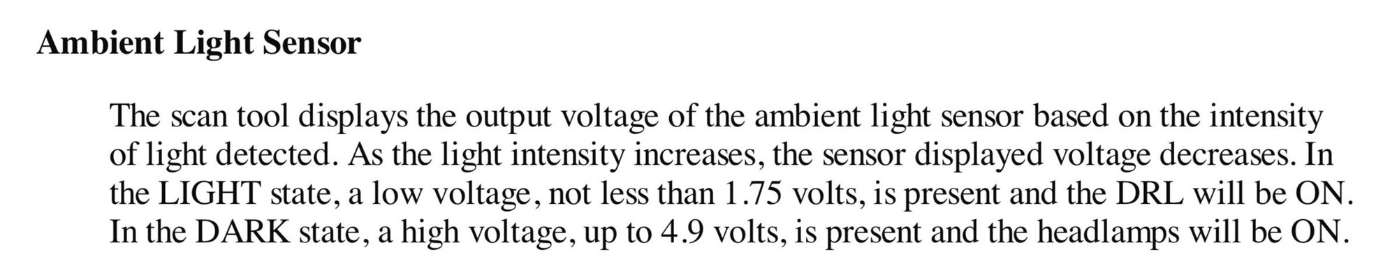

1) The term for the dash mounted sensor is Ambient Light Sensor, that is why a few of us did not recognize your acronym, LDR.
2) The truck could throw a code or some other problem with the BCM if a permanent resistor is installed in place of the ambient light sensor. I am not positive of this, but I am aware of just how sensitive our early Can-bus systems can be on these vehicles.
3) I did watch the video and it certainly looks plausible, but either you or ski.dive should try the modification and report back.
I am not interested in this mod and only ski.dive states he wants to drive in stealth mode, no lights on at night (why?)
It really isn't that difficult to just rotate the light switch counter clock wise after start up
Below are two images from the Schwarttzy service manuals that describes the sensor and its operation
