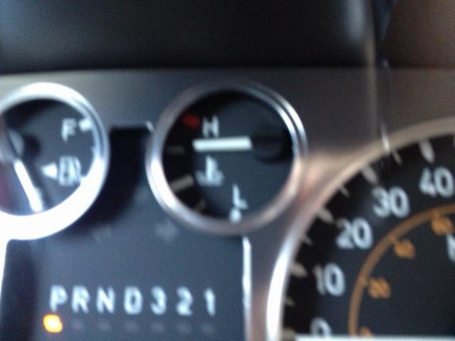

Posts: 15
I've noticed that the temp indicator tends to stay right in the middle area until outside temp hits around 100.

My temp gauge also does the same here in fl. If it is 85 degrees or less outside it stays at half if it gets up anywhere above 90 outside it runs up to the 3/4 mark but no issues to mention when that happens. These vehicles were meant to be driven hard off road and with that they have been equipped well in my opinion to handle anything I've thrown at it.
