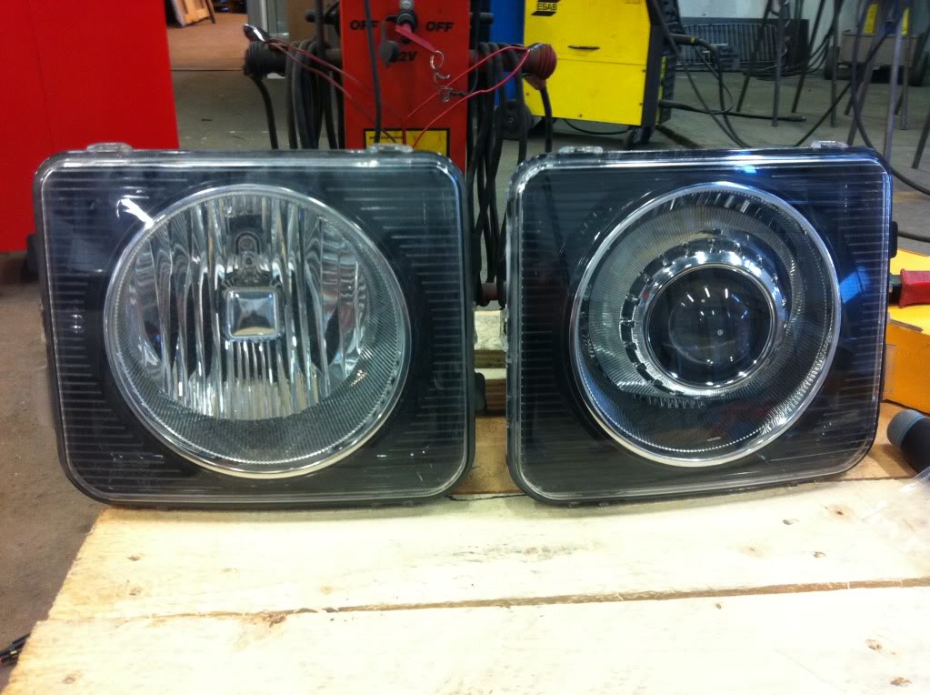

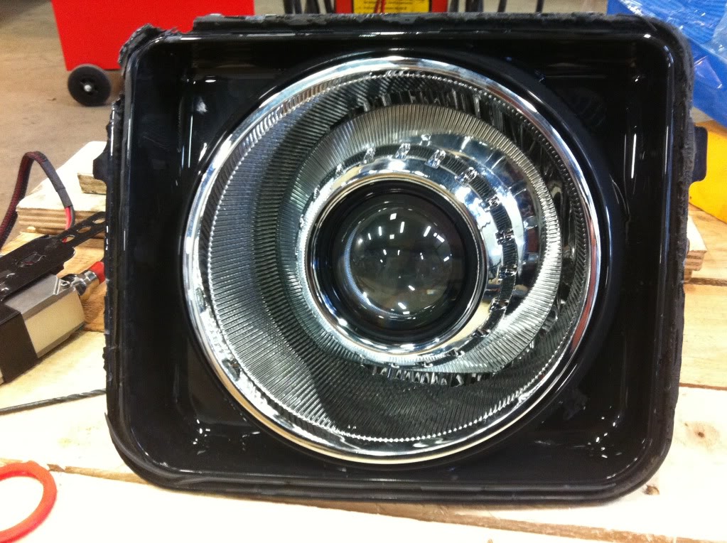

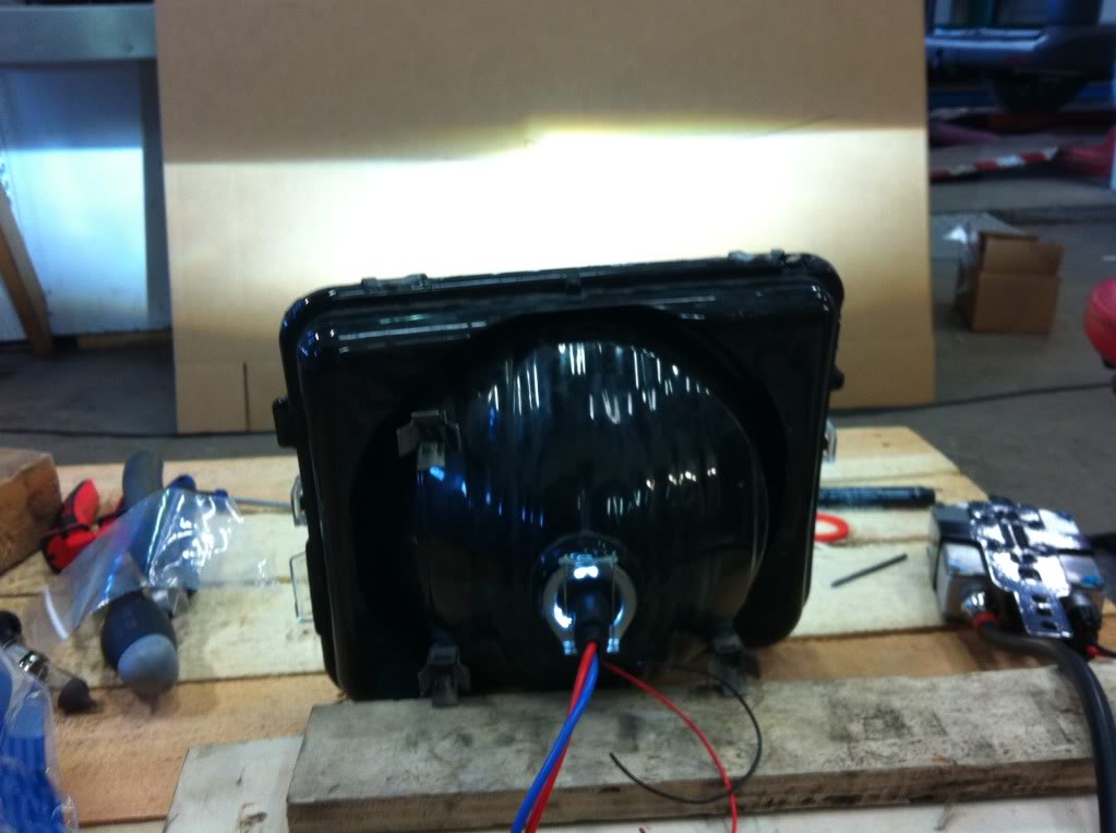

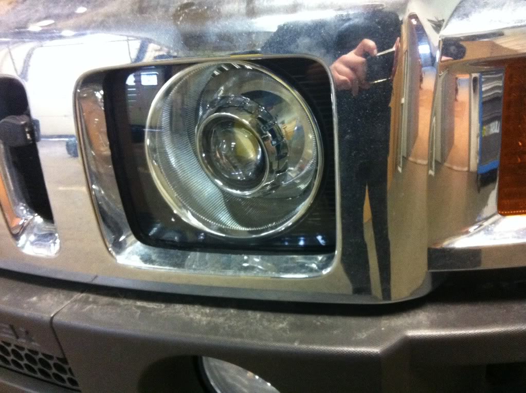

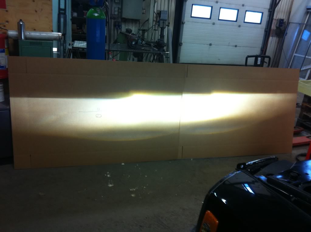

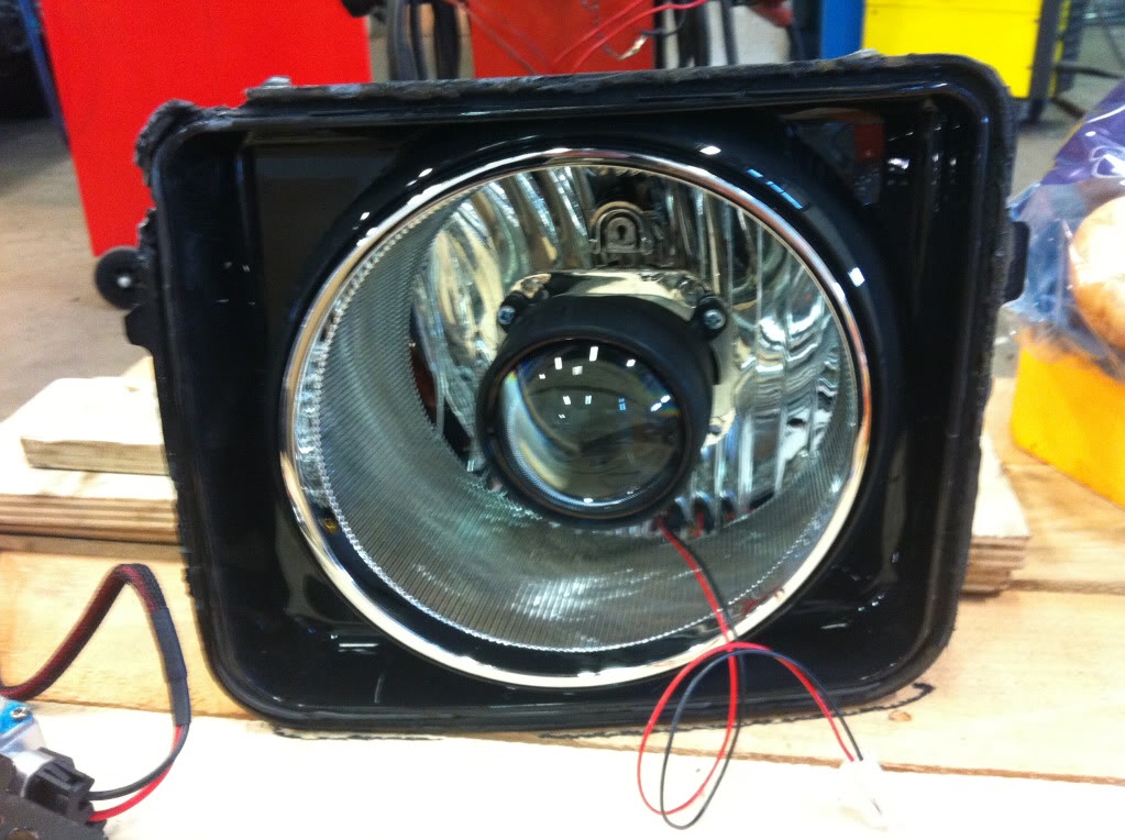

the STARR for 999 Dollars ????? WHAAAAT?
do it your self with theretrofitsource.com bixenon morimoto h1
Its some work though.
this weekend i got my retro done!

[QUOTE=hoken-ranger;245501]the STARR for 999 Dollars ????? WHAAAAT?
That looks very impressive. I have seen where some companies now sell the stand alone projection HID housing, but I was always concerned about how to retro them to the stock halogen housings or did you get other housings ?
It would be nice to know where you got all your parts and total costs.
As you can tell by my posts I have the Starr system and your way was not available back in mid 2007.
It looks like you have done a very good job. Nice pictures
