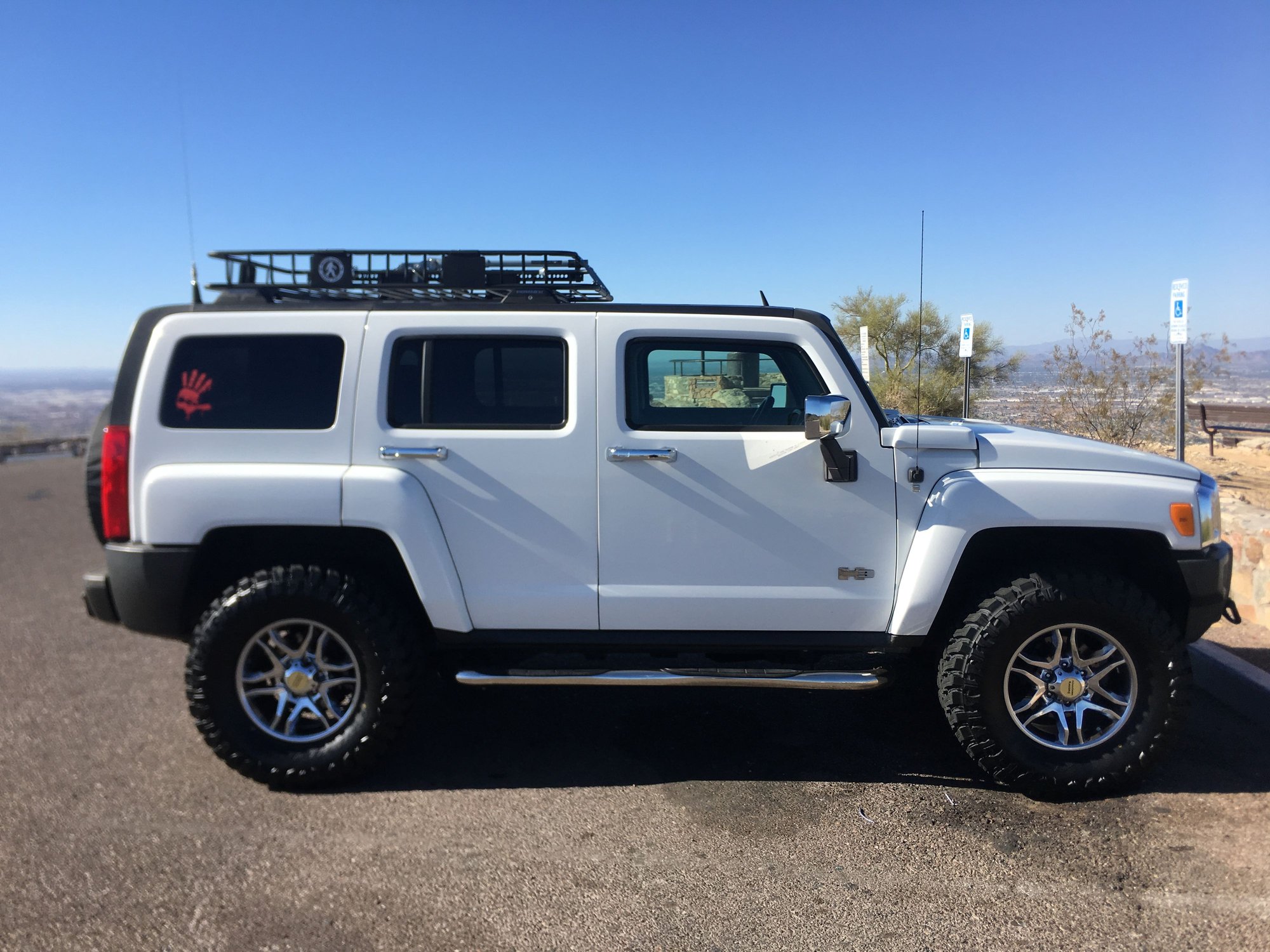

I watched this post closely and
decided to put 35’s on. I went with Atturo
Trail Blade M/T 35/12.50/17s (not a fan of chrome but were already there) These are great almost
no rubbing at all! And I like the tires, for being right under
a grand they have great reviews.
