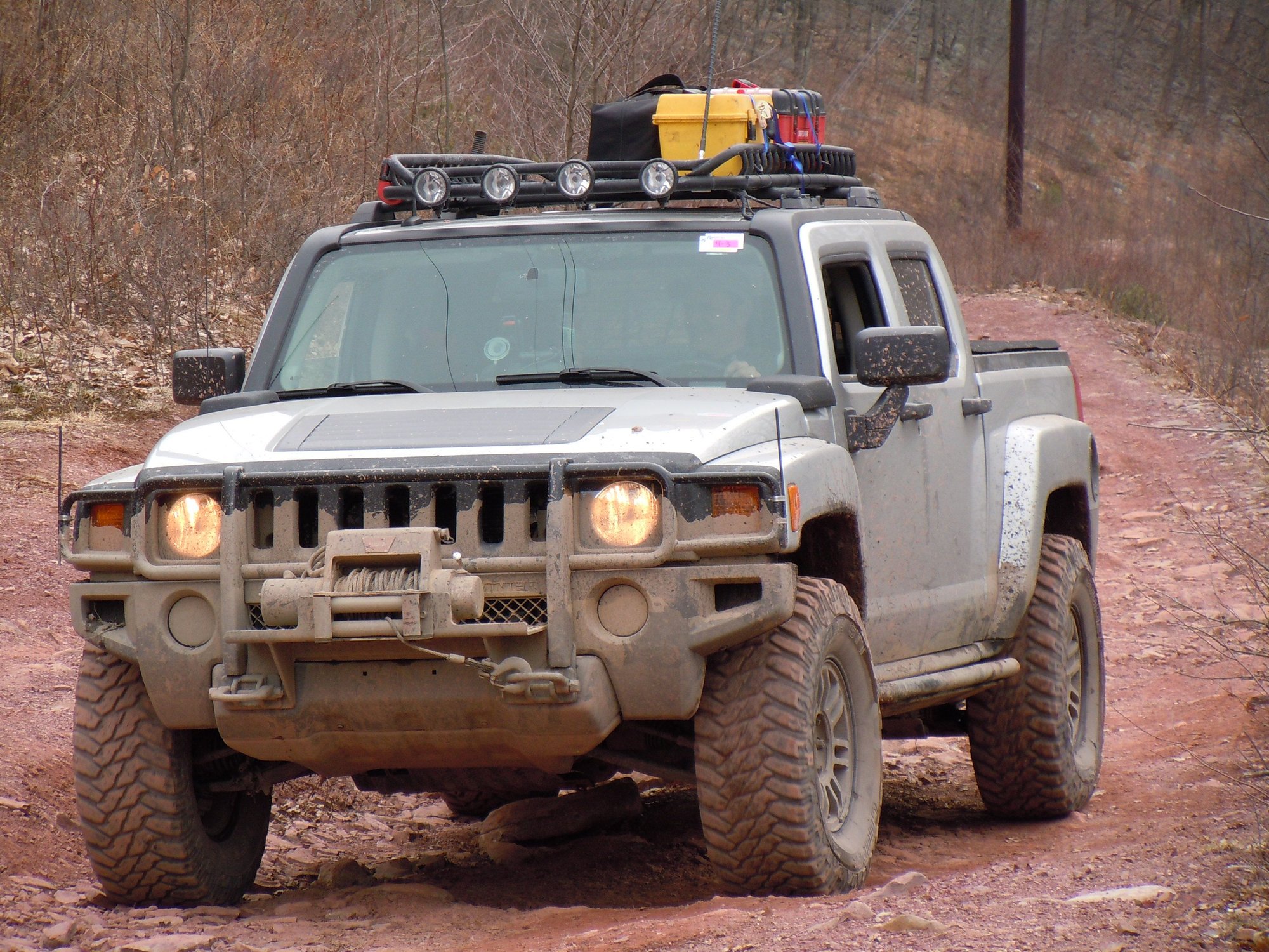

Here is CB Photos H3T on 35 Coopers.

I run 305 Mickey Thompson MTZs, same width as the 35s, but still 33" diameter. My truck has been adjusted to 23.4-23.5" for 10 years on stock adventure shocks, no issues, no spacers, no longer bump stops.
You do not need any spacers, no modifications at all. The spacer chat was when people though they could lift the front as high as 24" + fender lip to hub center, then
a 1/2" - 1" spacer may have been relevant. After years of guys wheeling these things, we figured out that 23.5" is the max front T Bar adjusted height before you start tearing stuff up.
The Cooper Discover is a great tire and would be an excellent choice.
When I find my Alpha it will eventually have 315s. Literally 1000s of people are running their H3s & H3Ts on 35s, not an issue.
