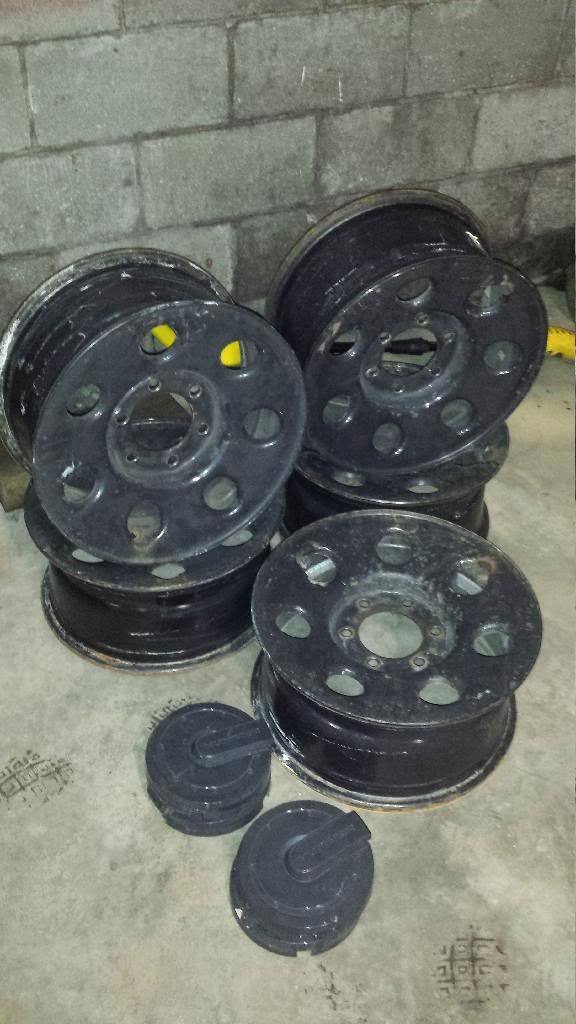

Base Steel Wheels

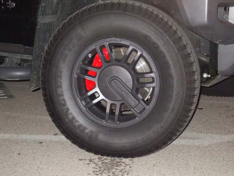

I like the look of the OEM 7 spoke slotted painted black

Ive never seen the black rims with soft d like circle before. Those are really quite interesting. Are they steel, aluminum? Even looking on the web I found very few if any images.
Old Sep 6, 2018 | 01:54 PM
Bunger's Avatar
Joined: Sep 2009
Posts: 1,356
From: Connecticut
Those rims are what came on the H3T spare tire. They are steel (AKA "steelies")
Since the spare is under the bed, they are rarely seen.
Some people liked the look and made full sets of the rims on their H3's and H3T's.
They are poorly finished though and rust easily.
