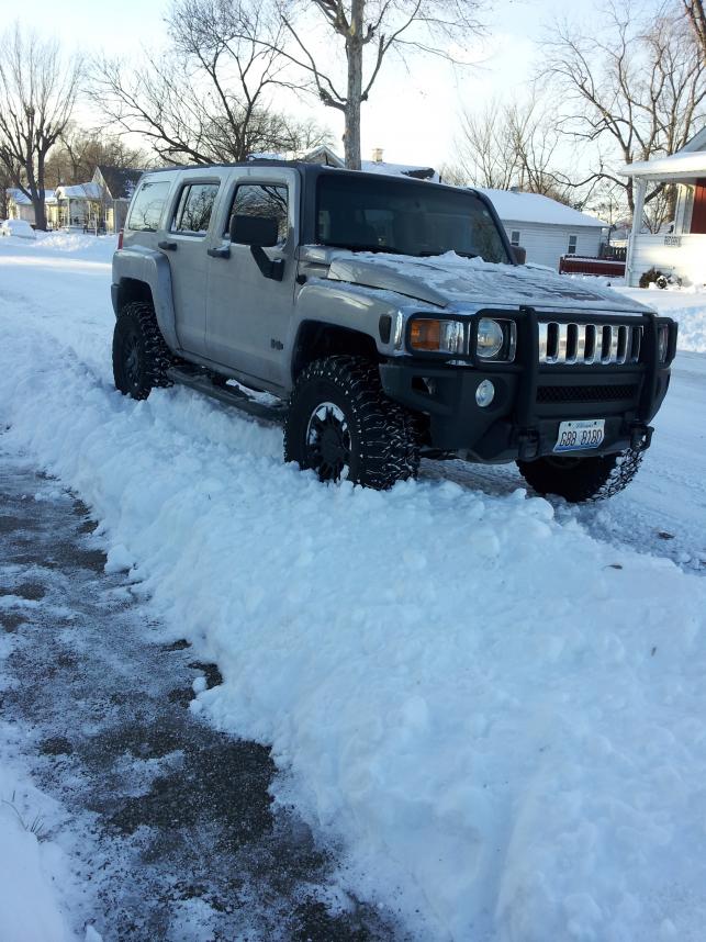

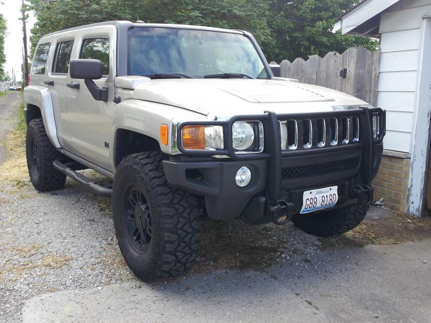

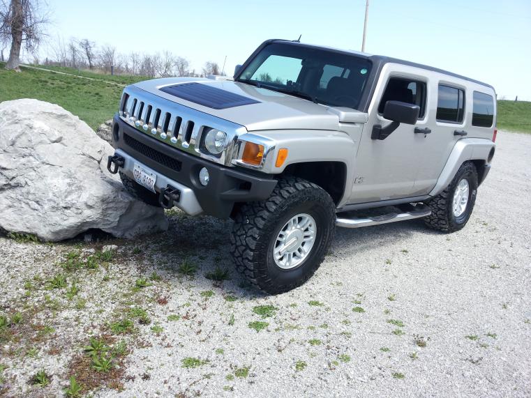

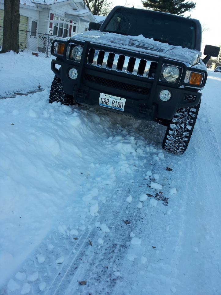

unless you go full custom the largest you can go is 4" roughly, and you could add a 1" inch body lift on top of that. Any particular reason you are wanting to go so big? Anything over a 35" tire causes too much of a strain on the drivetrain to make it a reliable logical daily driver and you can put on 35s with no lift, only cranking your torsion bars a little.

Here's mine on 35's with only the torsion bars cranked
Attached Thumbnails H3 lift????-20140106_160354.jpg   H3 lift????-20140106_160754.jpg   H3 lift????-20130413_133338.jpg   H3 lift????-20130522_170642.jpg
