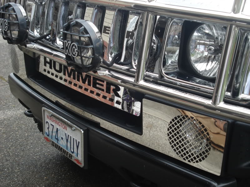

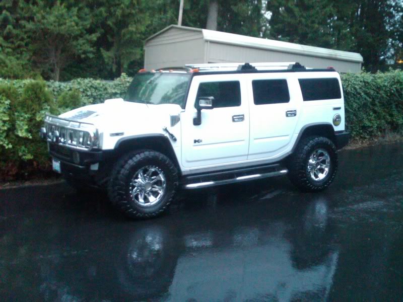

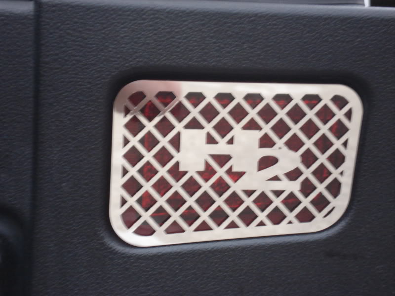

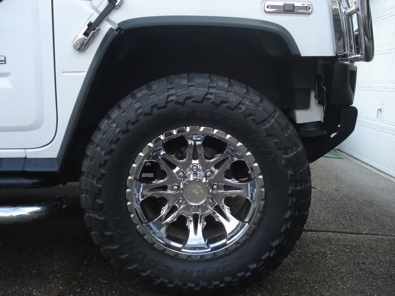

Here are some pictures. IT has the leveling lift with the keys swaped out and has 37in Toyo's on 20's. I know it looks like a pavement princess, but I do use it in all capacities. Towing, Hunting, Grocery getter etc. The other option photos are just some custom things I have done for these.

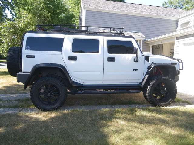

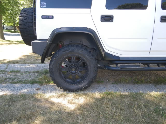

Considering you have 37s on the H2 already what are you trying to gain by lifting it? The suspension lift just allows you to put bigger tires, it doesnt give you more ground clearance. It is the bigger tires that give you more ground clearance. I have a Rancho 4" lift and I am running 37x13.50x22 Mud Grapplers. Basically the same tire as you but my truck is about 4" higher and has alot more wheel well but the same ground clearance as your H2 because we have the same tire size. The rancho lift allows me to put 40" tires on which would give me a extra 1.5" of clearance over you. So basically if you lift it, your truck will be higher but your ground clearance will stay the same unless you get bigger tires. Here is a pic of my H2 with the rancho kit.

Look how much wheel well I have compared to you and I have 37s on.
