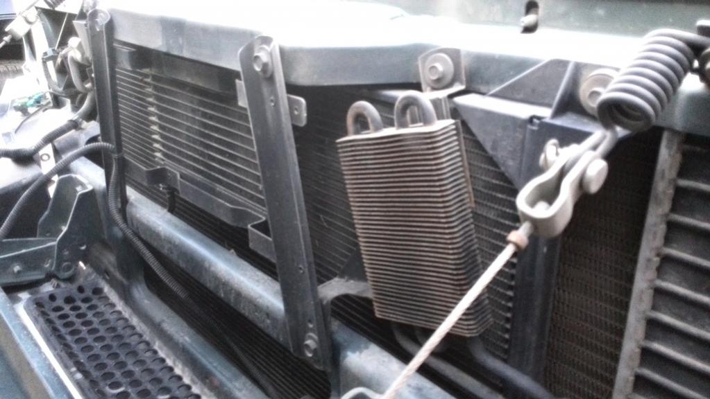

Regarding the transmission and its own cooling system, I took some photos of the radiator and there are little ones attached to the main one.
Is one of these for the transmission cooling system?

Attached Thumbnails H2-Things to have checked before buying?-img_20131109_171919.jpg

The smaller one in the center directly in front of your radiator is the transmission cooler. the small on off to the right should be a power steering cooler (I think) I'm not positive about that one but your p.s. pump is behind it and should be routed to it. the thin large radiator is your a/c and the big main one is engine.
