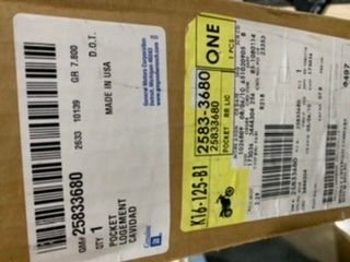

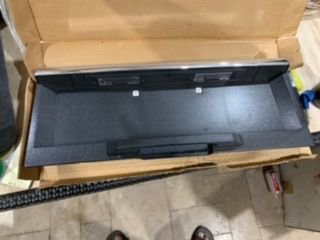

New in the box 2006-2009 license place surround. $125 plus shipping obo.

i thought you have a 03? isnt there a difference for 06-09?
Old Nov 5, 2019 | 06:25 PM
Yep - the upper part on the newer ones is flatter and has HUMMER embossed on them..... I can use either one but his picture shows an earlier style. Bought it either way as mine is getting pretty bad and cracking in more places.
Old Nov 13, 2019 | 10:44 AM
Came in today and it is the older style like in the photo..... just what I need. Thanks!
