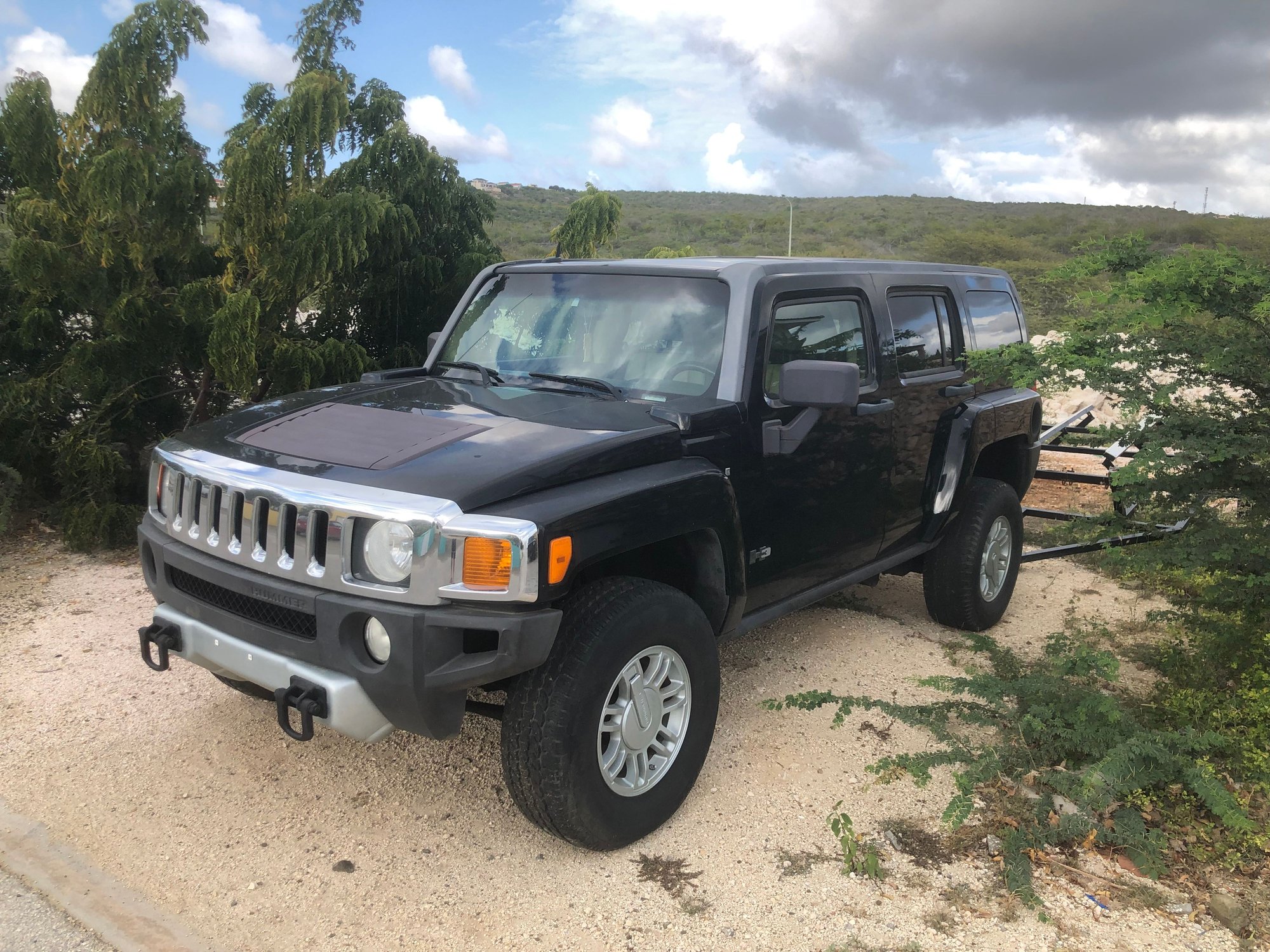

Hi everyone,
I own a 2008 Hummer H3 that has a bad transmission due to a radiator failure resulting in coolant and transmission oil mix.
I did a full flush and replaced filter but ended up losing 3rd gear.
Unfortunately where I live there is no expertise to rebuild - so I will need to replace.
- Can I just replace my current transmission with any year H3 or Chevy Colorado? ( 2006-2009 )
- And just as important, does anything need to be re- programmed on the vehicles computer?
I really love my H3 and my wife has one as well. Had them shipped from Florida to the Southern Carribbean.
Any info is well appreciated.!!!
-Sebastian
