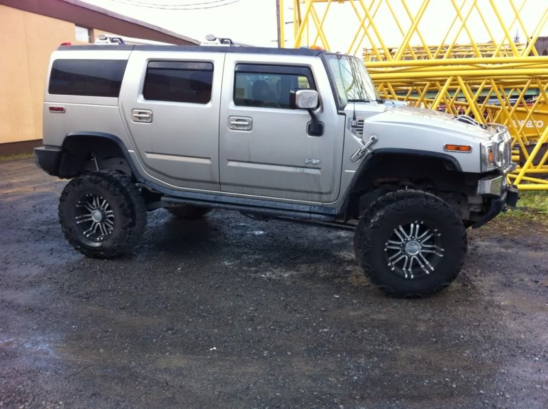

Old Nov 11, 2011 | 01:52 PM
Ryuhanzo's Avatar
Joined: Apr 2011
Posts: 24
So heres all my coolers and my awsome fuel efficiant suvXD
