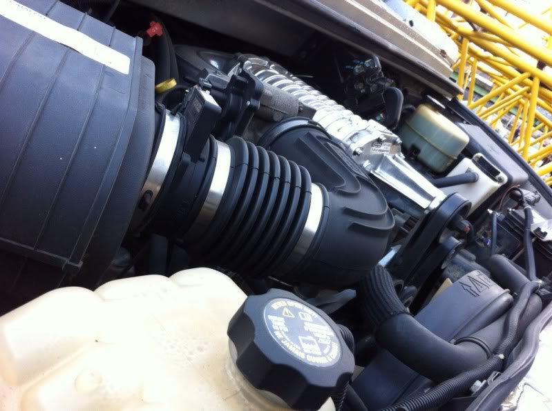

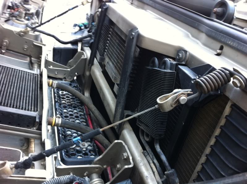

Ryuhanzo 11-11-2011 01:52 PM
8 Attachment(s)
So heres all my coolers and my awsome fuel efficiant suvXD
Attachment 15016
Attachment 15017
